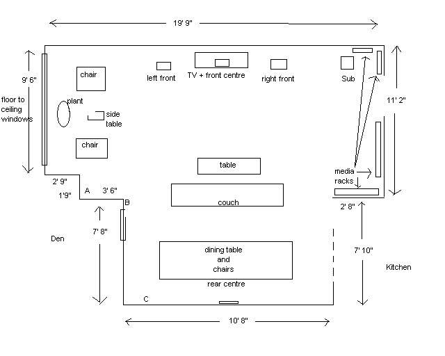

I've just purchased my reciever, a Yamaha RX-V750, and am about to purchase my Athena speakers, two AS-F2s for the left and right fronts, two AS-C1s for the front and rear centres, two AS-B2s (directed speakers) for the left and right surrounds, and an Athena AS-P400 subwoofer. The placement of fronts and centres are obvious, but I've been stymied as to where to place the surrounds. If you can see the jpeg I attached, I can place them at the spots marked A, B, or C, and their respective placements on the other side of the room.
Since the diagram is pretty crude, I'll also mention that the TV and couch are lined up with the centre of the rear-most wall. And that the distance from the couch to the screen of my 27" Sony Trinitron is about 9'. The distance from the couch to the rear wall is about 8' 4". And the distance from the side of the couch to the "A" mark is 6' 6" on the left and 6' on the right. Of course, the surrounds will be wall-mounted about 6', so that'll increase the distance a bit. The receiver can automatically adjust for distances of each speaker anyway.
The "A" mark is lined up with where the listeners' ears would be. The "B" mark at the corner is just behind the listeners' ears and is about 3' 6" from the side of the couch.
Ideally, I'd place the surrounds on the wall shared by the den and the dining area, about 2' 6" from the rear wall, but there's no corresponding spot for the right surround, cos it's only a half wall coming up to about 37"!
So, what do you guys think -- positions A, B, or C for the surrounds? Or is there a better spot I haven't noticed?

I'm thinking that the best spots are either A or B, I would avoid C, becaus it is too far from the listening position. Have you also thought about the option of ceiling mounts? But of course there is the WAF to take into account. :D

In a perfect world...yes. But we don't live in one :eek: I know it is such a shock! While the reciever has a auto-calibration thingie I don't think it would take into account of the opening to the kitchen, and the effects that would have on the sound.

Ok...maybe ceiling mounts ming not work, drilling through conrete is a pain in the butt. Looks like a wall mount in either A or B is your best bet. The best thing that you can do is set it up with the speakers in "A", listen to it for a while, then have some very nice friends hold the speakers in spot "B" and listen to them. Then decide which you like better.

Most people tend to put the surround L/R speakers directly in line with the ears (elevated about 2 feet above the listening position) or slightly behing but that is mostly a general rule....
You could put them on the back wall but I think the distance from your couch is rather far and might diminish the desired effect for HT.
Choice A/B is you probably your best bet, from looking at you floor plan, maybe moving you media rack(s) away from the right rear corner might be easier and placing your surround spkr on a speaker stand just before the kitchen opening might be easier to accomodate...

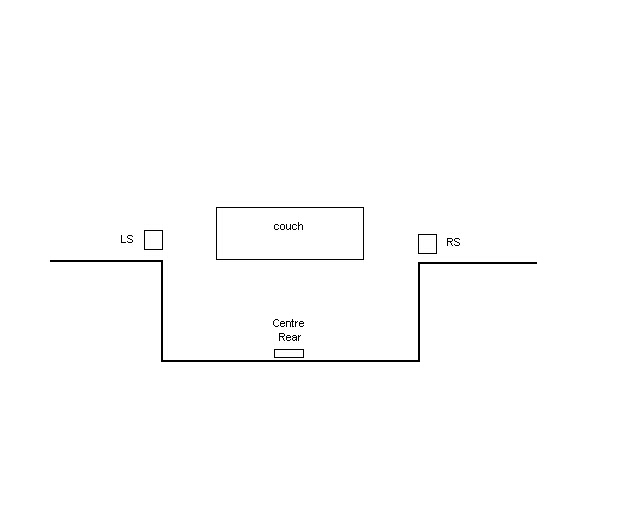

Speaker stands near the "B" position (see attached jpeg) and on the corresponding spot on the left side, seems to be what I'm leaning toward. I figure in the "A" position, the sound will spread straight out and to the forward of the room, but in the "B" position, the sound will have the opportunity to spread out straight and a little to the front AND back. Bit more immersive that way, methinks. But directed enough to sound cool for multi-channel music, not just movies.
Stands, definitely. Cos if I wall-mount, and then not like that spot, I'll have to drill someplace else. Too many holes and the place just becomes a mite drafty for my taste.
