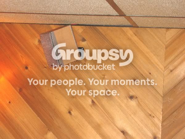

Here is a picture of one of my surrounds mounted on a pivoting bracket near the ceiling. Works fine.

mfabien, how high up is that speaker? Is it all the way up near the ceiling? How many feet above the listener's ears?
I don't really want to wall/ceiling mount my speakers; I prefer to have them more accessible, so I'm planning on just setting them on a couple of shelves. Facing each other, one on either side of the couch, and about a foot or so behind. (This would place them roughly between the couch and the not-often-used second row.) But before I install the shelves, I want to have a good idea at what height to have them.
I suppose I'll try to have the tweeters at 70". With the ears at the main listening area being at 36", that's just under three feet higher. And with the ears at the second row being at 46", that's two feet higher. The second row doesn't get used often, though. Still, whatchoo guys think?

The middle of the speaker is at 80" from the floor and the listening ear at 44". Therefore, the same difference you are aiming at, 36".
