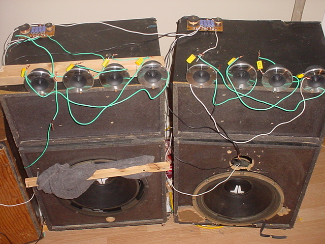

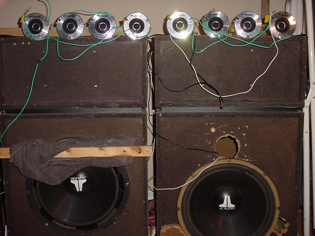

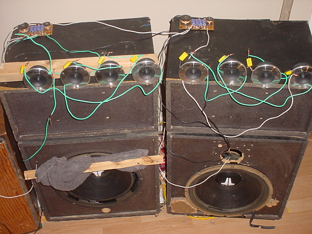

Highs like SSSSSS and bass like BBBBBBBB!!!!
Okay, okay I'm playin', lol. For the record tho, someone created an account and posted those to tell us how good they sounded.
Ryan is on point with his assessment. Every driver, crossover, cabinet and materials are all carefully selected, modeled and tested to make sure everything works together seemlessly. You can throw different components into different cabinets and crossovers, but unless you're win the lottery lucky you're most likely gonna end up with something that sounds like the ones depicted above.
I also agree that you shouldn't be discouraged and a kit with everything you need would be a great way to start. Until I dug into it a little more I didn't realize the amount of work and research goes into every well built speaker.

View attachment 30302View attachment 30303
(C’mon... those were just the test cabinets. :p)

Seeing those tweeters, reminds me of radio shack back in the 80s, they sold this super tweeter, that's what it was called.
Actually.... The crossover is also from the Shack; 40-1299 universal 3-way.
Kvn_Walker...we have the same last name..;). anyways yeah, them super tweeters, I remember back in the 80's two friends of mine had those sitting on top of their speakers. The tweeter where incased in a plastic housing. B&W has tweeters on top of their higher end speakers. Seems to work for them. I personally I'm not a fan of a driver outside a speaker cabinet I'm sure it sounds good just not for me.
