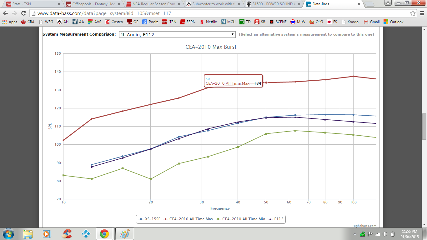

Btw...full array of measurements are available at Databass for you to look over but you can see these 3 subs measure very close when you overlay their numbers.

Have a look at PSA XS15se (Jim Wilson again):
Now take a look at the JL Audio E112 (Jim Wilson). It is worse than the Ultra and doesn't come close to the much less expensive PSA!
