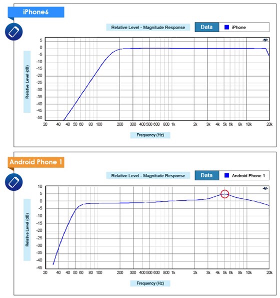

Have you used an spl meter to level match everything? It’s important to establish a baseline every time you move it anywhere. Then if you like more/less bass, adjust accordingly. Also, iirc the pb1000 is a little higher Q design. Basically it sacrifices a little driver control for output. I would verify levels, as I feel adjusting by ear is a little arbitrary.

I have used some spl meters which I downloaded from my phone, perhaps I should invest in a proper one!
IMO a good spl meter is always a good investment. Here’s the response curves of two different phone mics. You can see why they would not only be Accurate in the lower register but also inconsistent from phone to phone.
IMO if you have a laptop or other suitable device that can accept a usb measurement mic, and download RoomEQ Wizard (REW), that would be far more useful than just an spl meter....
Totally agree. The difference being cost of entry and learning curve
