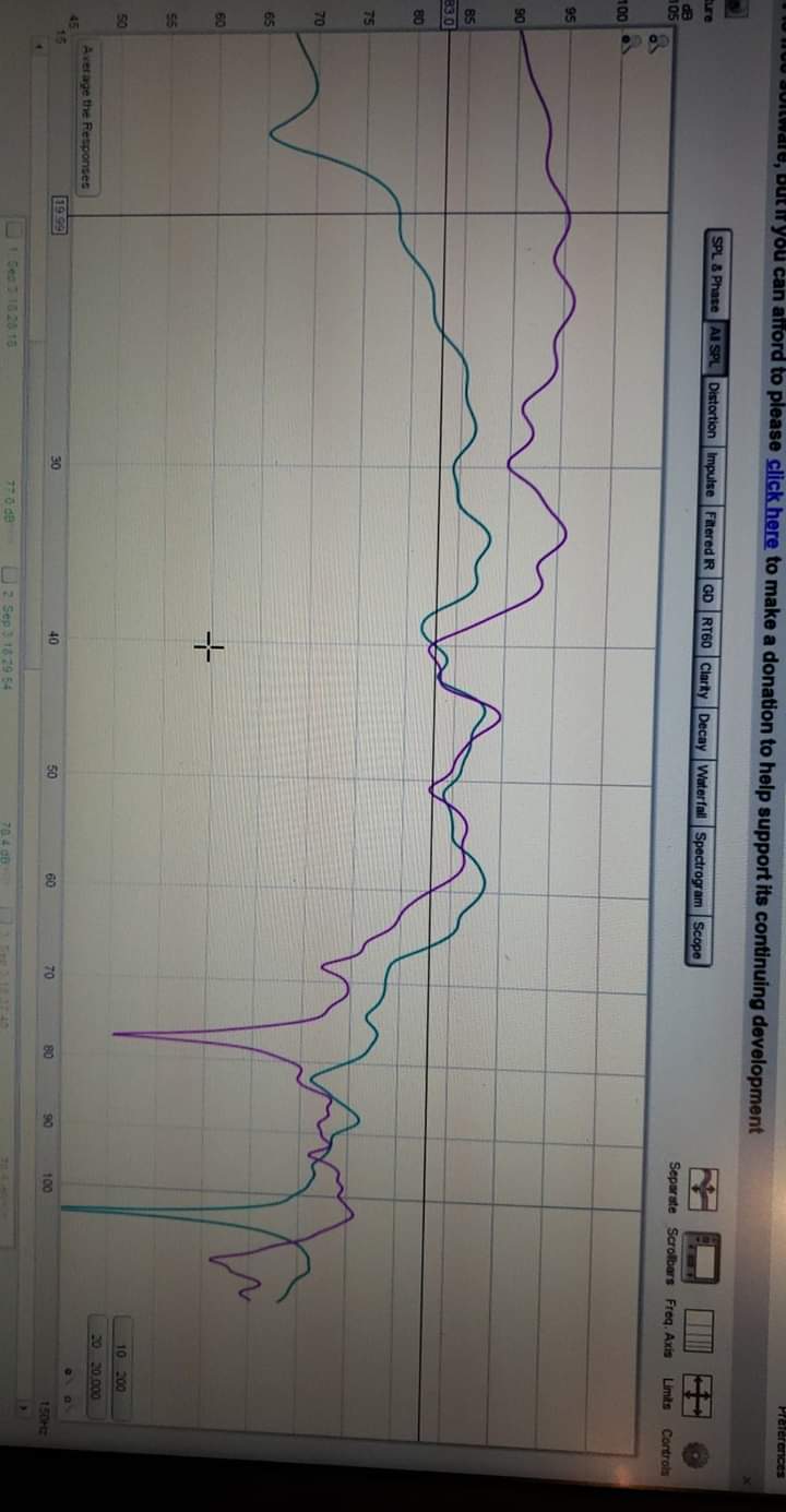

Hi Shady, I currently have it set up as 1 port open, q .5, eq1. I liked .5 the best as I thought .7 was a little on the boomy side, while .5 tightened it up but still provided that deeper rumble. My location for the sub was measured with REW and while definitely not ideal, gave me the flattest response I could muster with one sub. I had to compromise with either a dip in the 60-80hz range or a dip in the 20-50 hz range. So I went with the higher output in the lower frequency range.

Just FYI you can use the camera icon on rew pages to save the image. Then you don’t have to take a picture. It’s a lot easier to evaluate. Like this..
