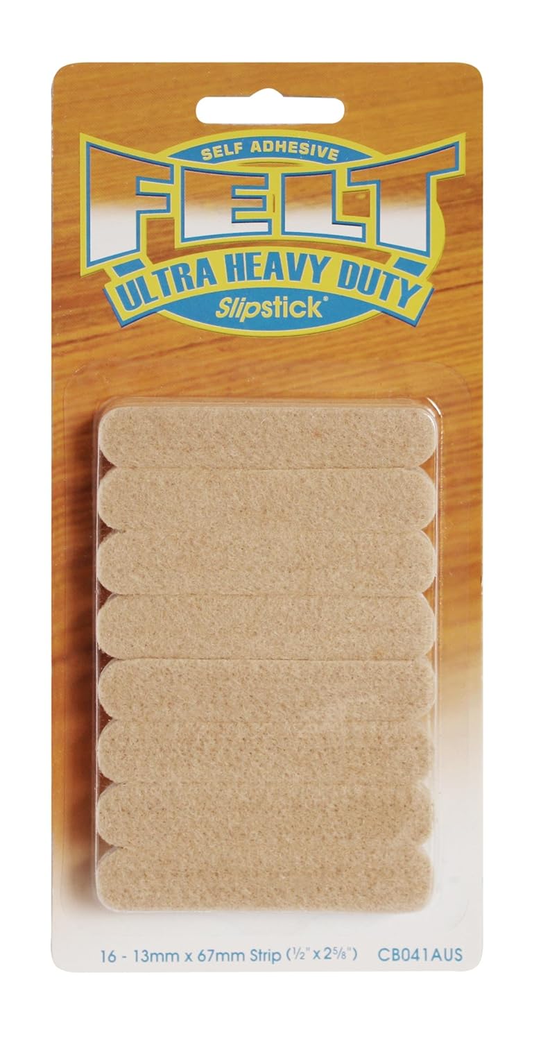

  • Put something under the turntable to absorb vibrations. Something cheap and simple, like 2 or 3 magazines can quickly tell you if this works. If so, get something soft but stable, like thick wool felt. I found Soft Touch heavy duty felt pads in a hardware store. They come in a variety of sizes, and are sold under a variety of names such as SoftTouch, SuperSlider, Slipstick, etc. I got ½" × 2+5/8" strips and stuck them under my turntable. There are a variety of expensive 'audiophile' items sold for this purpose, but they don't work any better.
