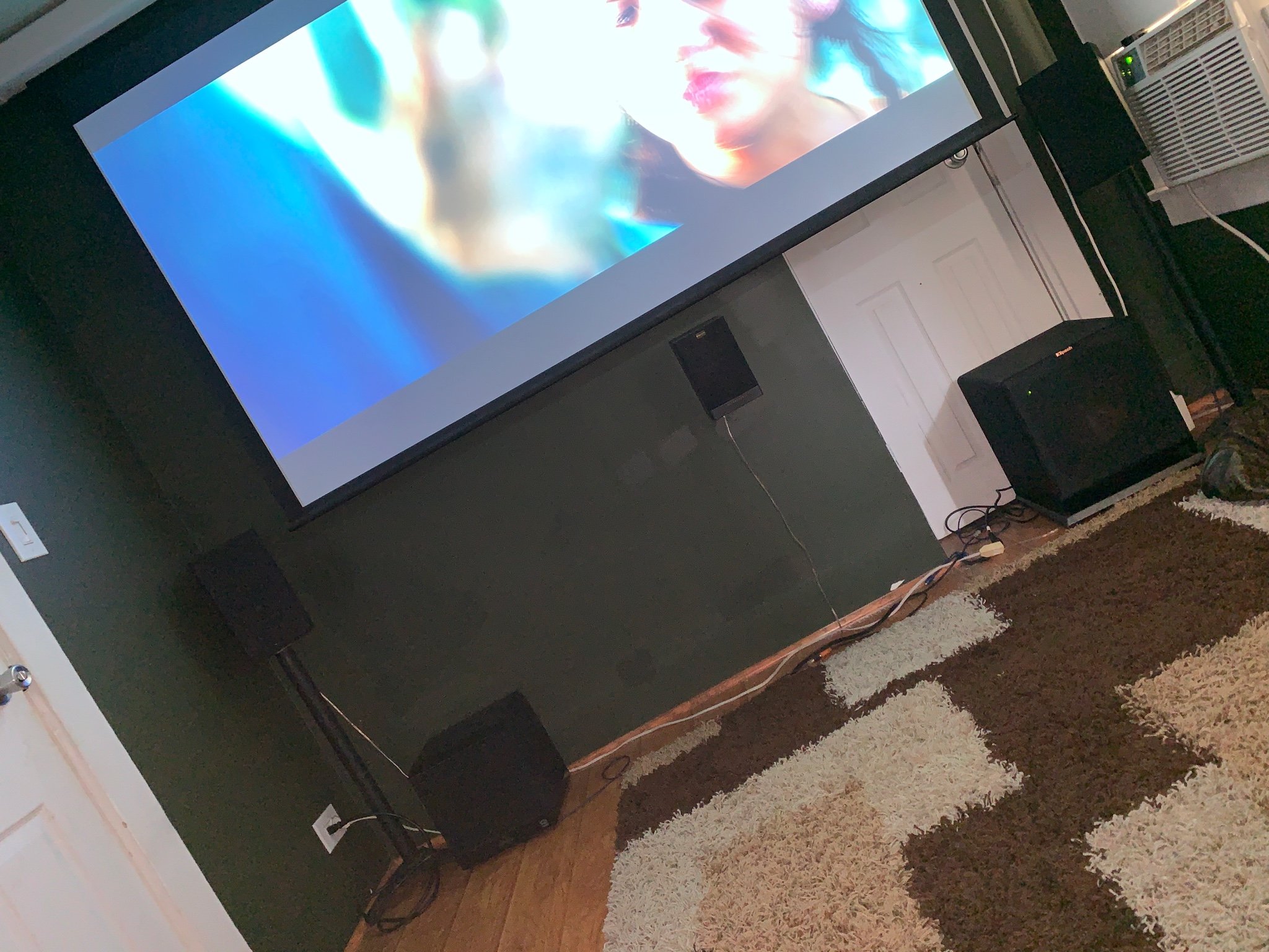

You guys think is a good idea or would it be a waste of time and waste of money
And just rather buy a used sub
At the moment I have a klipsch r110
And I want to add a second sub to get better response cuz I feel like there is a lot of standing waves or cancellations of some sort
The room is very small
Is basically a cube
Is a square room so I know is hard so I’m basically trying to get the best performance
Right now my brother let me barrow his super cube 4000 and it made a huge difference
Still have a bit of complications in some frequencies tho

So the room is a closed room is not a open area or living room
The room is 8 feet by 9 feet and ceiling being 9 feet tall
And I have both subs up front and like I mentioned I am only using my brothers sub just to see if it made a difference
And for a receiver I am using a Yamaha aventage
Is a 7.1 but I am only using 5.1 at the moment I feel like the room is too small for 7.1

Oh and another thing I have one sub set to 0 phase and the super cube is set to 90 I think
C
cesar ortiz
Audioholic Intern
Current set up not the best but is ok to watch movies every now and then
Stereo speakers are the hvl-1
Center is a old klipsch reference book shelf speaker I had
And the rear are klipsch also
