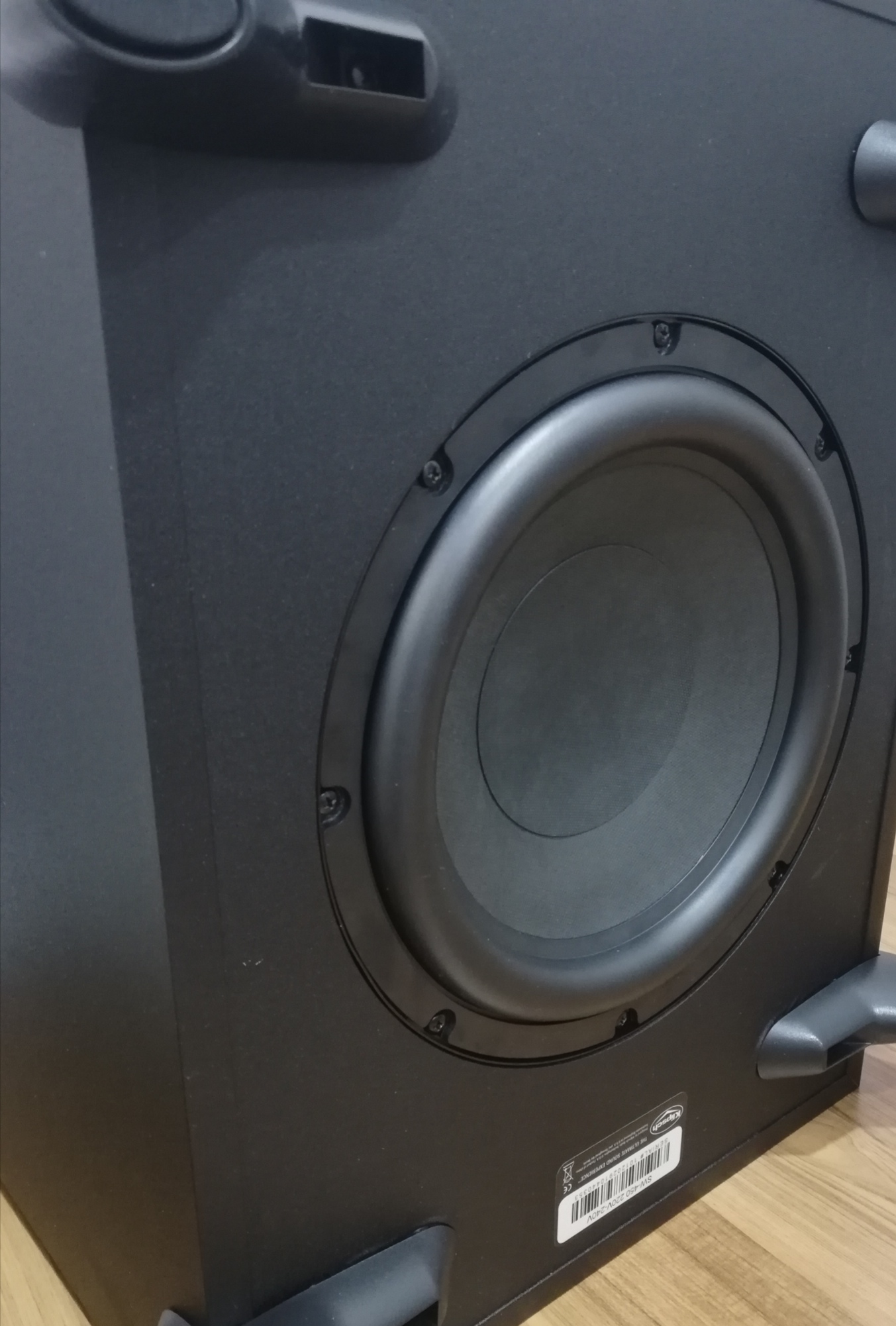

Hi,
I have a Klipsch SW 450 home theatre subwoofer.
Its plate ampli is malfunctioning. Upto now my technician couldnt repair it.
Woofer is in good state. I need an amplifier suggestion.
I listed the specs of the sub below.
I only use sub (LFE) output from my Denon receiver, therefore crossover circuitry is not needed.

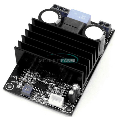

I contacted several amplifier sellers from ebay and aliexpress. But they said their products are not suitable for my sub.
I dont know why.
Here some examples i talked with sellers:

I don't think that one is going to work for you. Note that he uses an external DC power supply. Easiest replacement will be one with a built in power supply just like your Klipsch, so all you need is an AC power cord and connect the speaker wires to the plate amp. The tough part is finding one the same size to cover the opening properly.
The board from AliExpress in your original post also requires a DC power supply, which needs to be factored into your costs.
