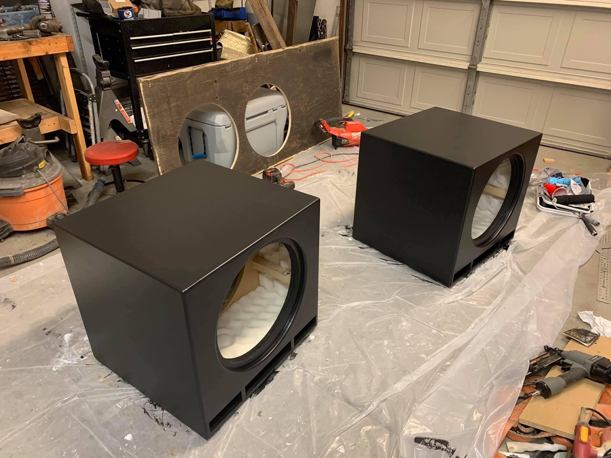

Might consider building your own to your own aesthetic preference (either yourself or hire a capable carpenter/cabinet builder or maybe the help of someone local into audio diy)? Don't know what's available to you in the way of suitable drivers there.
JasonGSG
JasonGSG
Great recommendation.
If the OP is interested in a DIY project build of a pair of nice 18's I'll happily provide Cut sheets & measurement data.
Drivers from Lavoce, B&C, Eminence & Beyma should all be available in NZ plus several amplification options
C
concorde
Having just finished building my stereo amplifier, I am interested indeed, in building subwoofers. But only if I can build something with similar performance to a top end subwoofer, like the D15S etc.
I would like to see the data and cut sheets!
You can do quite well with diy....but you'll need another amp...or two, depending how many subs you build :)
MalVeauX
MalVeauX
Those GSG Marty Subs are the way to go. You can get flat packs there and build them easily with just clamps & glue. Source the drivers and electronics in NZ with no import. Will kill any commercial sub for cost.
