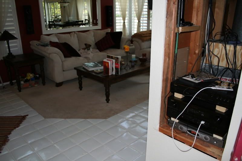

Velodyne spl-1000r front firing long excursion sealed (1000W RMS)
crossed over at 80hz via AVR
I have little placement choice for my sub so I am planning to place it on the floor beneath a niche cabinet that I am installing. This location is almost directly beneath the TV but behind a wall and about 10' in front of the listening position. Pics should help visualize

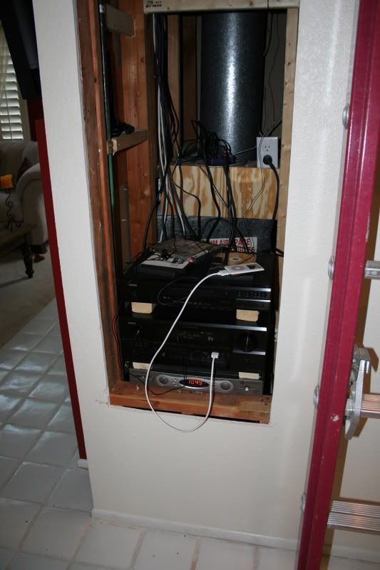

Niche is in the foreground, as you can see there is a firebox in there.
This is where it is looking from the couch. The niche is on the right, so the sub is lower right of TV.
Looking at the niche.
So the sub will actually be below the cabinet. I plan on installing a grille in the wall to vent the sub space. My questions are
1. Is this even remotely a good position?
2. Is placing this in the same space as a firebox a recipe for resonating disaster?
3. Can I retrofit some acoustical insulation around the sub to improve both sound and resonation properties?

First, I am planning on cutting two 6x12 holes in the drywall below the cable tuner. I'll place passive HVAC grilles over them. The sub is front firing toward them so I somehow think this has to be a good idea.
Second, I need to deaden up that firebox somehow. If I press on it, I can get rid of a lot of the resonation. This makes me think if I pad it with dynamat or something, it might help. Suggestions please. BTW, the firebox is a "cool" unit only requiring 1/2" clearance.
Third, I'm thinking of somehow blocking off the space that the sub is in from the space the firebox is in. Probably with some 1/2" ply and acoustic insulation.
Anyone have a clue if any of this stuff is a good idea, or if I should do things differently?
K
kenhoeve
just in case somebody ever looks at this thread, here are some answers I got after consulting Tweeter and Velodyne.
Deadening the firebox:
1. dynamat makes a material suitable for high temperature, used that to cover the face of the box facing the sub.
2. using insulation and straps, i tightened up the flue in 3 positions up to the next floor.
Enclosing the sub:
1. Velodynes can be used in closed cabinet situations per manual.
2. Subs move air, it is wise to leave it open to as much air as possible.
Grilles:
1. I cut a hole large enough to remove the sub through the wall using a 16"x16" hole. Custom made doors with fabric for fascia.
Positioning:
1. Maybe it isn't the best, bet articulating the unit to bounce off an adjacent wall to the listening position is the best you can do. Placing something smooth as a reflection point is a good idea.
