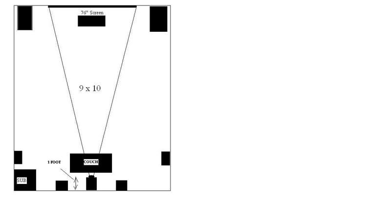

I have a small HT room. It's 9x10 feet. It's a projector setup with a 9 feet throw distance. My couch is about 8 1/2 feet from the screen. Now, I have a 5.1 setup, but I was wondering whether I would benefit from a 7.1 setup? I know Blu Ray has announced some 7.1 mixes, and I will get a PS3 eventually for my HD needs. Anyways, I have my 5.1 setup the way Dolby advises. I don't have much room in the back for 2 additional speakers. I planned on wall mounting them 6 feet high and pointing downwards.
I've heard several people mention that having speakers too close to you can break the surround field behind you and sound too positional or direct. Just wanted to hear some thoughts on the matter. I added a pic to illustrate my desired 7.1 setup. My equipment is in my sig if it helps.
MDS
If you only have 1 foot or even a few feet behind the couch, I wouldn't bother with 7.1. The surround speakers and especially the rear surrounds in a 7.1 setup are mostly for ambience and the occasional direct sound where the mixing engineeer intended the sound to come from behind you; in other words they aren't utilized all that much.
In a small room you can get surround effects from even two speakers up front (because the sound bounces off the walls). A well done 5.1 setup will be much better than the overkill of extra rear surround speakers for 7.1, IMO.
Still, if you really want to experiment with 7.1, I would suggest dipole or bipole speakers to spread the surround info around. Regular monopole speakers one foot behind you will get really annoying really quick.
