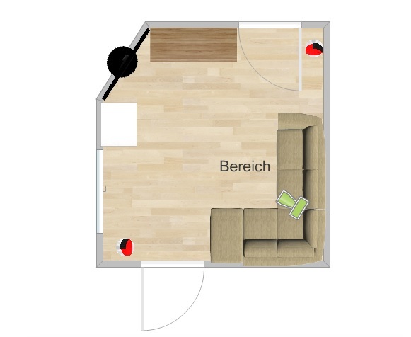

Because I don't have much free space in my room, I'd be happy with a 2.0 solution, where I don't need a subwoofer or a center. My room looks like this:
The TV is drawn black, white and brown are some desks. To the left there is a window. As you can see, the geometry of the room is special and the only free space for standing speakers would be in the corners (the red dots - they would be 5 m apart, as the room is around 14 m^2 big).
