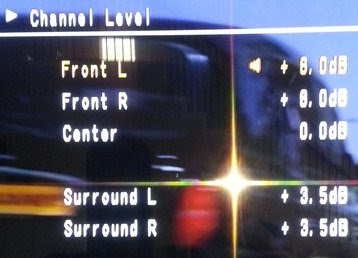

I went through the Audyssey set up with the Denon receiver and it adjusts the channel level for my front 2 75T speakers higher than my center channel. I believe this is normal, ... since if I set them all the same level, the center channel sounds a bit too high. This is an image of what my 5 channel levels are set to:

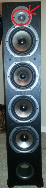

I removed the front covers of the speakers and listened closely to each part of the speaker. The static sound is coming from the tweeter. However, when I do play something, I hear sound from the tweeter. I included a picture below to show where this static sound is emanating from:

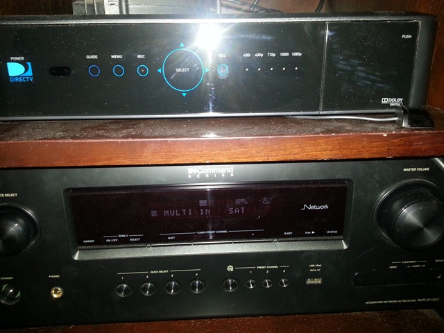

For more information regarding my system, here are some more details. I hear the static sound even when my DirecTV box is turned OFF, but my receiver is set to its input. I have a picture shown below of the front of my receiver (the flash makes it look like the DirecTV is on, but it is off).

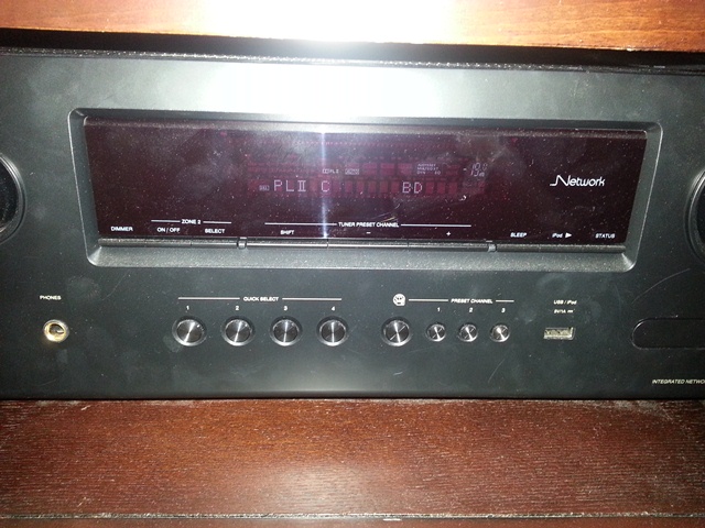

I also hear it when my HTPC is in sleep mode but the Denon is set to the HTPC input. An image of my Denon during this case is below:

Blown tweeters are generally pretty obvious - they either sound horrible or make no sound at all, so that is less likely as well.
Try altering the placement of the main speakers and re-running Audessey. Speakers don't hiss, they only reproduce hiss. This is coming from the receiver or sources or your power lines.

However I note that Audessy has set the gain high. Actually I think Audyssey has made a mess of things. I think that is is very unusual for the mains to have to be set to +8db.
I would go to the speaker set up and set the mains to 0db. Set the center to -8db. Set the surrounds to -4.5 db.
I think Audyssey has set the gain too high and this has degraded the signal to noise ratio. The tip off is that is that in Direct mode it largely resolves.
I think there is a good chance that Audyssey has also got the relative levels wrong. I would check the levels with an spl meter.
