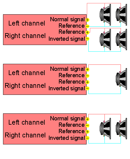

ahh, much better, with the knowledge i have, I think this could damage your amp. Read this:
As you saw in the previous discussion, a 4 ohm mono load is the same as a 2 ohm stereo load as far as the amplifier is concerned. Looking at the diagram below, configuration 'x' shows a 2 ohm stereo load. Configuration 'y' shows a 4 ohm mono load. If both amplifiers are driven to the same output level, the current flowing through the outputs would be equal. In configuration z we have added another 4 ohm speaker bridged onto the amplifier. This means that the load has doubled which means that there is only one half of the impedance of configuration 'y'. Remember that impedance is the opposition to the flow of electrical current. An amplifier depends on a high enough impedance to prevent too much current flow through the output transistors. When the load is lowered to 2 ohms mono as in configuration z, the current flow through the output transistors is doubled (4 ohms mono vs 2 ohms mono). The amplifier's maximum safe output current may be only slightly higher than that needed to drive a 4 ohm mono or 2 ohm stereo load. When the amplifier tries to drive the 2 ohm mono at full rail voltage (40 volts) the safe operating area of the transistors will (more than likely) be exceeded. Keep in mind that we are talking about the most common types of amplifiers which are designed to drive 2 ohms or higher per channel (2 ohm stereo stable and 4 ohm mono stable amplifiers). There are amplifiers (high current amplifiers) which are designed to drive low impedance loads. These amplifiers have more transistors and heavier duty components to withstand the increased flow of current through the output transistors.
With that, the impedance will be able to travel down 2 channels, instead of one, cutting in half the impedance. I'm assuming that your amp drives a 4 ohm load on the sub, and each of your subs are 4 ohms, meaning that if you hooked up 2 in parallel, you will probably fry your amp, because the amp isn't getting the 4 ohm resistance that it needs, which will let too much current flow, which will fry you amp. However, if your subs are 8 ohms, and you hook 2 up, that will cut in half and make a 4 ohm load, the rating your amplifier is rated at.
