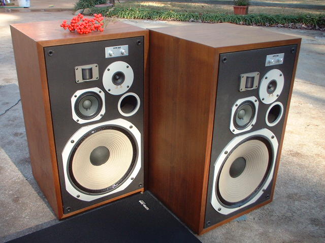

And BTW, I know what your talking about when it comes to "20 years ago". I have a pair of speakers that matches your description. Maybe you know of them, Pioneer HPM-100. I still use them.
Pic:
Different speakers for different purposes.

Those are about 30 yrs old. Carbon fiber woofers. A little too bright for my taste, but good units overall. Those would seem to be a great HT speaker! Dynamic and a bit bright. Just need some mag shielding!
They sit to low for HT.
You can turn the brightness down with the POT.
