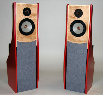

I don't know. But, one speaker that I wish I listened to, and might recommend checking out here, are some Linkwitz speakers, like the Orion. Similarly to ML stators, they will benefit from having several feet away from the front wall. And dipoles are generally designed so that we are placed in the null. Since they are using dynamic drivers, perhaps that might allow a compromise between your typical speaker and the beamier electrostats, but I can't say for sure. The dynamic drivers should be able to handle greater volumes before suffering compression as well. AJinFLA has these, I believe. He says they are similar in sound to electrostats, but enjoy greater output without the compression.
http://www.linkwitzlab.com/orion_us.htm
