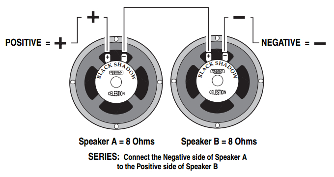

Unfortunately what you need does not exist. Your speakers are four ohm. Your best option is to use two controls side by side.
Your speakers are four ohm and I can not find a control that will handle a 2 ohm load. So you can use your existing control with series wiring making an eight ohm load.
So you need to make two series pairs. So for each pair you need to connect one speaker positive to the the other speaker negative and then connect the remaining unconnected positive and negative wires to the control.
This is going to spread the power in the room and make it more even, but it will not increase the volume. If it is more volume you need then you need to add that two extra amp channels with more wiring and use two controls side by side.
THIS!
I know it's a few weeks old now, but they don't make one off volume controls for weird setups. Instead, wire your speakers in series and use the volume control that is already in place. You will get more even audio distribution, but you aren't sending additional power, so you will still have what you had before.
Not sure why the additional speakers are in use, or what the goal was. Feel free to elaborate, but if you are looking for more overall volume in the room, then you will need to drive them off a separate channel of the amplifier, and that means you will need a second volume control to adjust the audio level for those speakers.

What happened to "Never connect two 2-way speakers in series when they have a crossover"?
