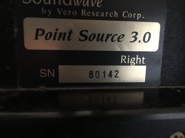

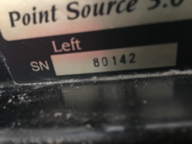

Soundwave Point Source 3.0 by Vero Research.

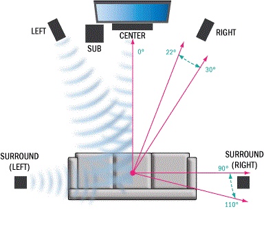

Just for reference...

If you look at the picture William posted, that's where you would want to place surround speakers in a 5.1 setup, or as close as possible. I wouldn't even pay attention to any rear speaker outputs unless you have 2 more and just use the surround/side outputs for your surrounds.
Exactly my point. They will make noise behind the LP, but it serve as more of a distraction than an inclusion to the material.

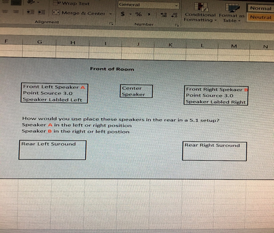

My original question was.
The speaker that is labeled "left" is placed facing the front to the left. Should I then turn and face the back wall and place the speaker to the left? Or should it be placed on the back wall in the revered position?

Bob Leonard
Bob Leonard
Front of Room
Front Left Speaker A Center Front Right Speaker B
Point Source 3.0 Speaker Speaker v Point Source 3.0
Speaker Labeled Left Speaker Labeled Right
How would you use place these speakers in the rear in a 5.1 setup?
Speaker A in the left or right Rear position
Speaker B in the right or left Rear position
Rear Left Surround Rear Right Surround
Pogre
Pogre
Front of Room
In a 5.1 setup I would place the speakers in a surround position (on the sides of where you sit, not behind or rear), and have them face toward you in your listening position.
On your image above, the seating should be right in between the boxes labeled 'rear', with the speakers pointed at you. I would not use any 'rear' outputs in a 5.1 setup.
