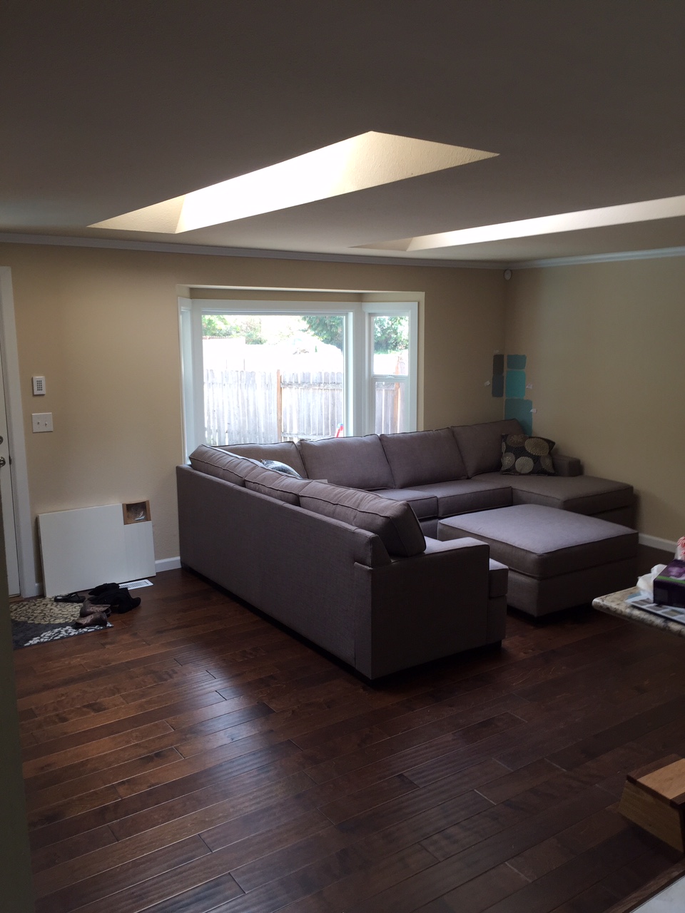

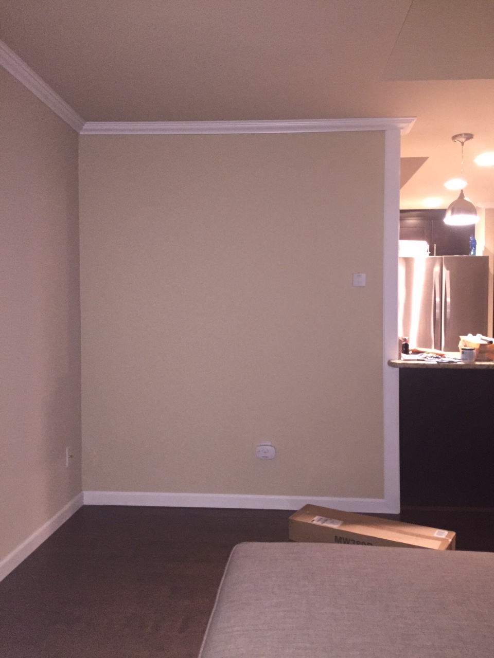

3) In the pics I'm attaching you will see my room layout, it doesn't seem completely ideal. You will see my finger pointing to the corner. I want to put a large TV hanging bracket there w/ the extend arm for 50-60" TV. I will have low maybe 24" tall floor cabinet to put my equipment in, subwoofer next to it. These are my thoughts, big question is, what would recommend for location of audio in this room the way it is setup.

Putting the TV in that corner is probably not the optimal solution for audio. Even so, your Center should be in the center of your TV, either above or below, as close as you can get it. Then your L/R should ideally be equidistant from the Center. You can adjust the L/R some w/ equalization.
These 3 should be pretty easy, even with the corner location. Your Surrounds will be a bit more of a challenge. If you loathe visible wires, you may have to consider ceiling speakers. It won't be great, but better to do that with your surrounds than your L/C/R.
