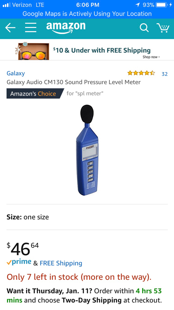

When I play the test tone I raise the volume to 75 and change channel level setting +/- in settings until the spl reads 75 also. All channels set the same way.
William Lemmerhirt
William Lemmerhirt
What are you using for an spl meter?
