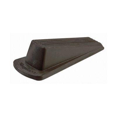

maybe you could get 4 of those rubber door stops to put under the front edge of the speakers to point them up slightly at ear level while still keeping a safe mount.
I use those door stops to point my center channel down a little.
home depot has these cheap

Ear level is defined by the centerline of the tweeter, not the top of the speaker. The tweeters should be right around ear level. For dipole/bipole surrounds you could put them above the listening position as they are intended to be diffuse, however for monopole (direct radiating speakers) I agree with the recommendation to have them at the same level as the mains.
I use Auralex Mopads to angle my center down:
http://www.auralex.com/sound_isolation_mopad/sound_isolation_mopad.asp
those are cool,I did'nt think about them for my cc. :) I will have to look at those,thanks for the idea :) .there is a "Guitar Center" here local that has good prices on auralex.
