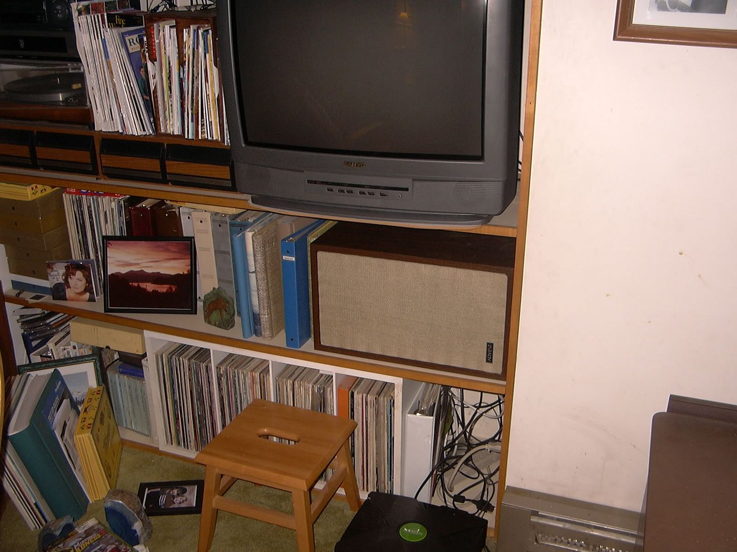

I have a couple questions. I am building a third identical speaker for use as a center channel. HERE is a picture of where my center speaker is. As you can see, it's sort of boxed in. My question is, should I put the port on the front of the center speaker? I can do it, the problem is that it would look funky.
My second question relates to the gauge of the inductors. My existing crossovers have 18awg air core inductors and are the correct value so that I can reuse them in the new crossover. The 18awg inductors are nearly half the price of the 15awg ones. Would using 18awg inductors affect performance?
My final question involves capacitor values. PE has caps for every value in the schematic except 6.0mfd. The closest is 6.2mfd. Is this a big deal? I could use two 3.0mfd to get 6mfd but I am trying to keep parts to a minimum.
