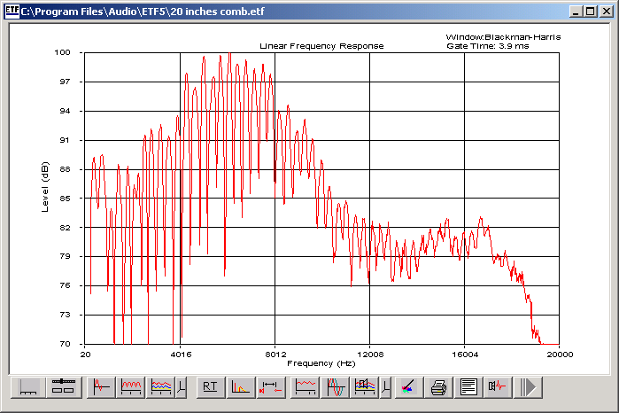

The mechanism is called Acoustic Interference. When sound waves strike a boundary they reflect back into the oncoming source. This creates a series of many peaks and deep nulls called "comb filtering." The distance from the source to the boundary determines the peak and null frequencies. This graph shows the frequency response measured 20 inches away from a bare sheet rock wall:
