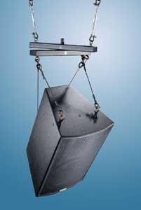

Just hang them from the ceiling just high enough for people to walk under
