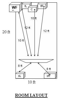

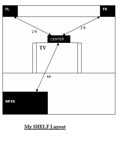

Hi jcPanny
Sorry for not understanding :(:(.
I am new to this. I measured the distance from my listening position to the speakers and i set it up. Even though my front and center speakers sound is improved , Still my surround speakers volume is very low..very hardly to hear.
And Now my woofer boosts too much bass.
My room size is 10 ftx20 ft . My settings in feets ,
Front : 12 feet , Center :10 feet. ( I set front speakers distane 2 feet more than center speaker ..since it's placed 2ft above my center speaker. Is it right ?)
Surround Left : 8 ft, Surround Right:8 ft.
Woofer : same distance as center speaker.
Pls refer the attachment containing room layout which explains my room size and placement of speakers in my room and Shelf_layout which explains how my Center , Front and Woofer has been placed in my shelf.
I called up ONKYO and they were telling they will cahrge arnd 40$ for installation and they told me it would be set right only with professional installation. It seems like it's a marketing technique..
I beleive i can resolve it myself ...

To set speaker distance just measure the distance from the main listening position to your speakers tweeter and input that to your receivers memory. To set loudness levels go to radioshack and buy an SPL meter either analog or digital, I prefer the latter. Attach the SPL to a tripod if possible and set to to C weighting, slow. Run pink noise, static, from your receiver speaker level adjust screen through each specific speaker setting the loudness of each speaker to 75 DB. After this all your speakers will be the same loudness so it should all integrate much more seamlessly. On thing you should realize is if you don't watch movies loud enough the mix might sound as if the surround are too faint that is just how the movie was recorded as they are designed to be played at 85DB.
