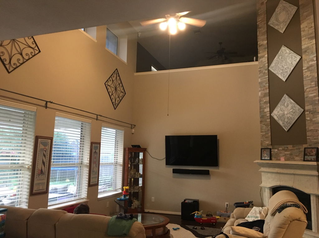

@Dave Williams I think the greatest opportunity for improvement immediately would be to hang some drapes and lay down an area rug between the TV and couch. I think some of the intelligibility issues might be solved by some acoustic absorption. You might also play with corner loading your sound bar's bass module and turning its volume down. Or better yet, pop it up on the couch, then crawl around the room to find where the bass sounds best. Then move the bass module to that spot.

Thanks for the suggestions. I do have a very large rug in place. I am familiar with sub tuning. The sub isn’t the issue. Plenty of output. I turn it and the soundbar bass down quite often to try to make the dialogue more clear. It doesn’t really help.
Is that soundbar aimed at your ears? From the pic looks like it is higher up....then again might not help much. $2K for a soundbar? Wow. Sorry no onwall suggestions for you, never looked into them.

It’s only about 6” above ear level. Well, $1,800ish but yeah. It really does sound good with music. Just a quite a bit of echo in here.
Hard to tell from the pic. That is a cavernous space with lots of reflective surface....
OTOH have you tried tilting the soundbar down a bit?

You could try replacing your wrought iron art with acoustic panels. Assuming you're in the United States, contact Acoustimac with dimensions and photos of your space and see what they recommend. I'm no expert, but I bet panels above the entrance to the kitchen, between the fireplace and TV, and above the drapery rod would make a big difference, not just for watching television, but for the comfort of the room in general.

While 5.1 will allow better sound than a sound bar, I suspect eliminating some of the echo will be a better approach to actually solving the issue of hearing the dialog clearly!
