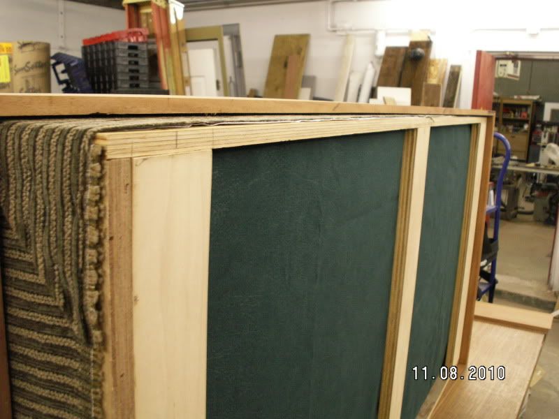

So I been collecting a various assortment of stuff for several years ...
Actually this is Eddie's stuff. It makes up the inner frame.

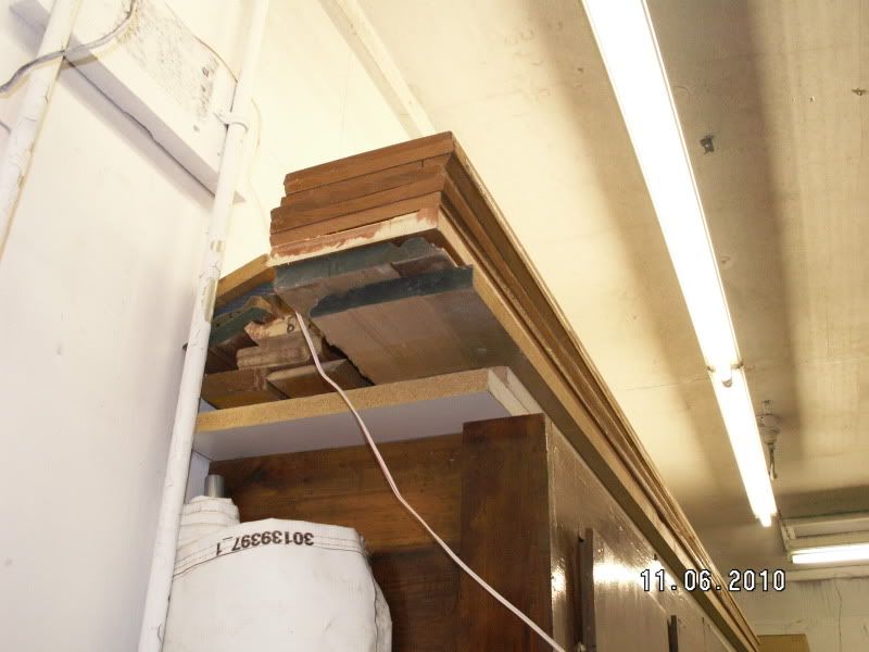

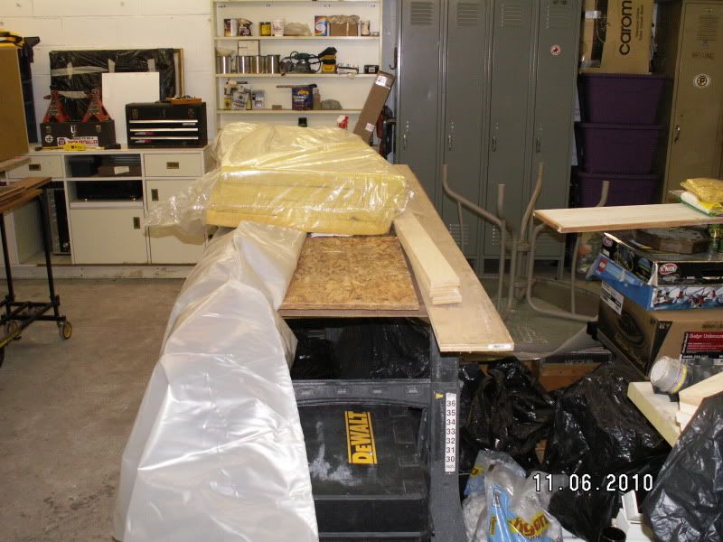

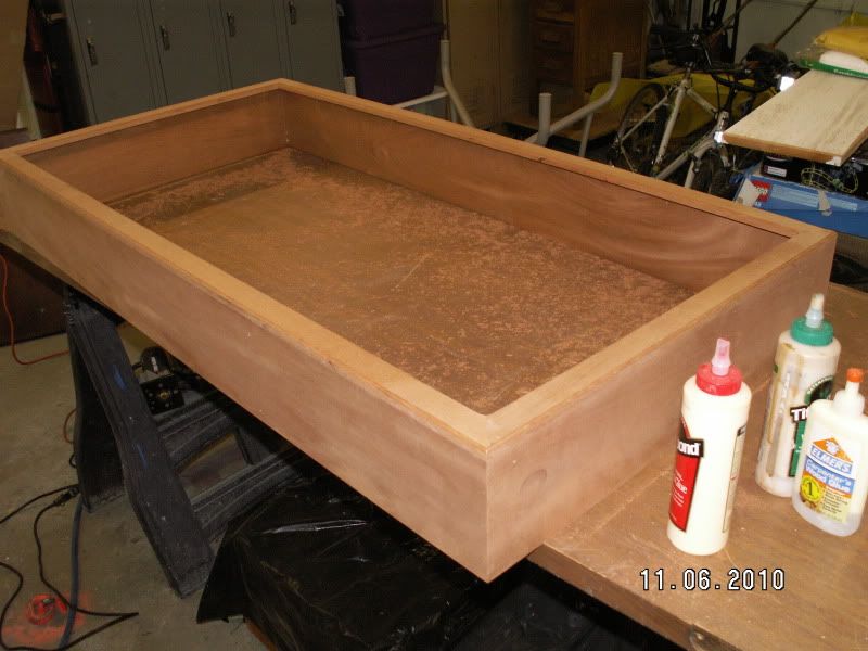

This is a pile of Mahogany that I scavenged from an elevator lobby some time ago.
Here's the 703 and some more ply that makes up the back of the inner frame.
This is an assortment of fabric in the back of the fofo that ran me about 70 bucks ... not to mention 20 more dollars for decent fabric scissors. That's just the tool junkie in me.

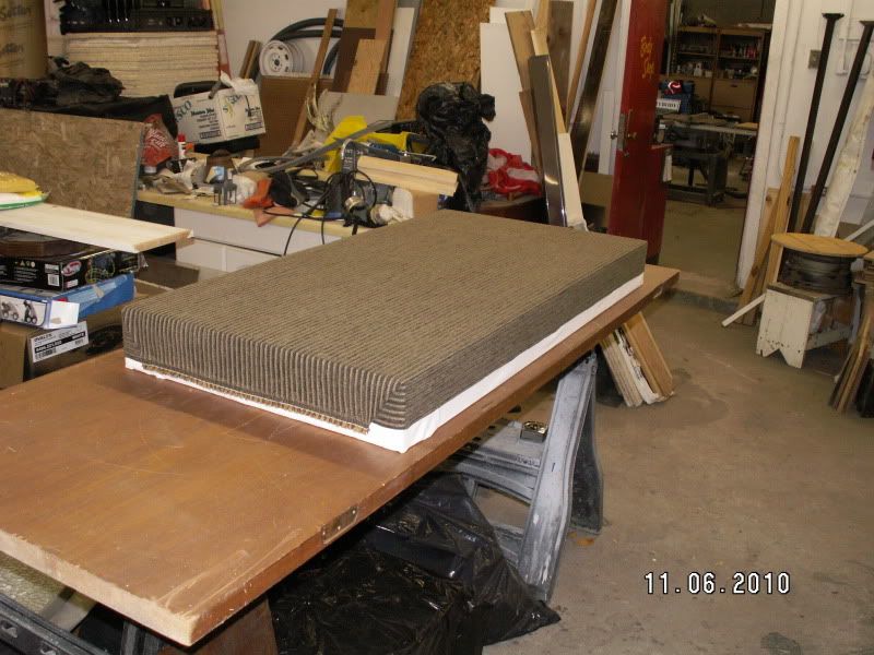

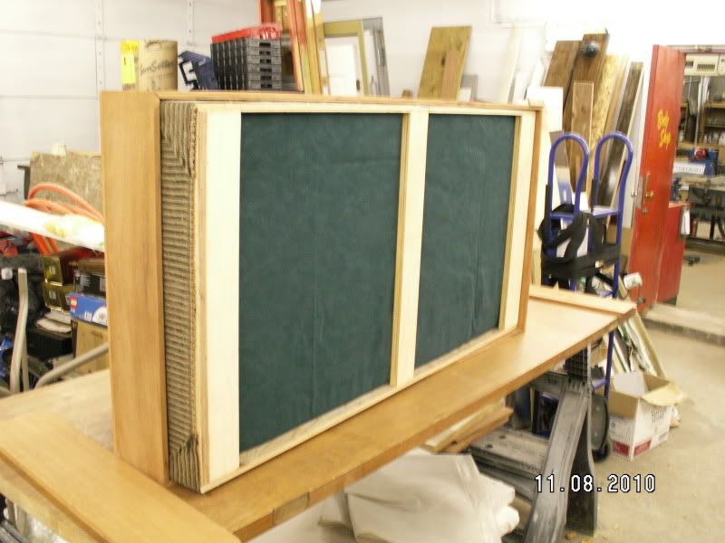

I stuffed a couple of pieces if 703 into the inner frame on top of this fabric that doesn't breath for beans but sound has to go through 4 inches of 703 to get to it.

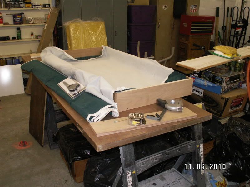

I covered the 703 with cotton muslin and then the fabric of my choice.

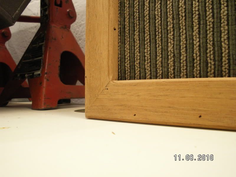

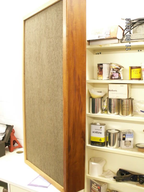

Then I put together this Mahogany outer cover and ran a router around the edge to give it a little detail.

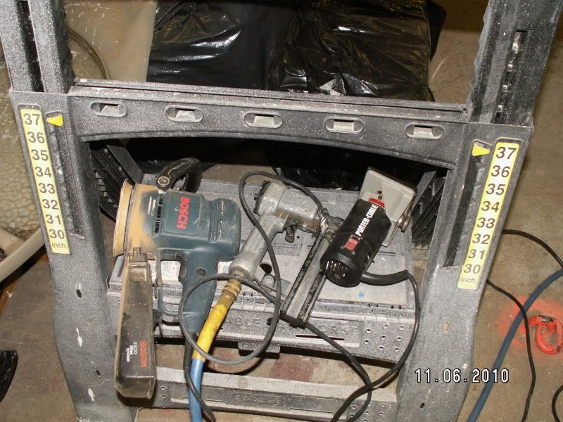

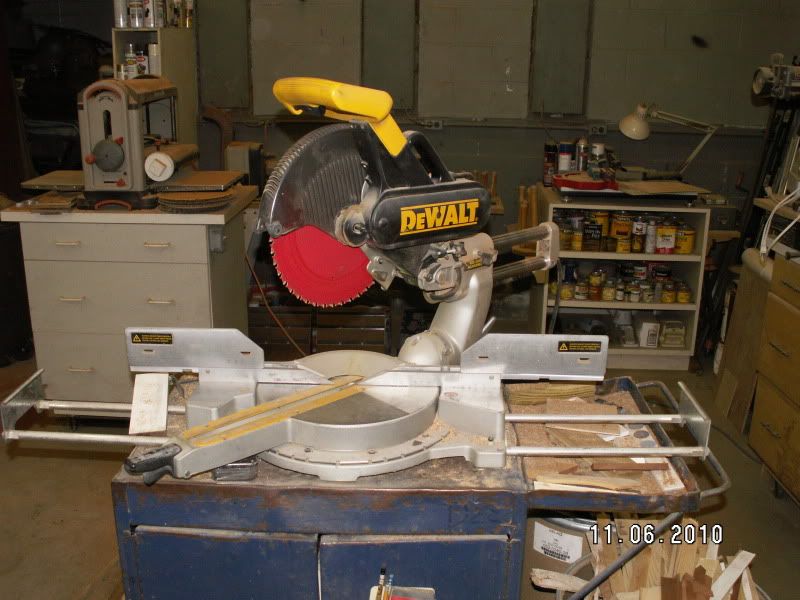

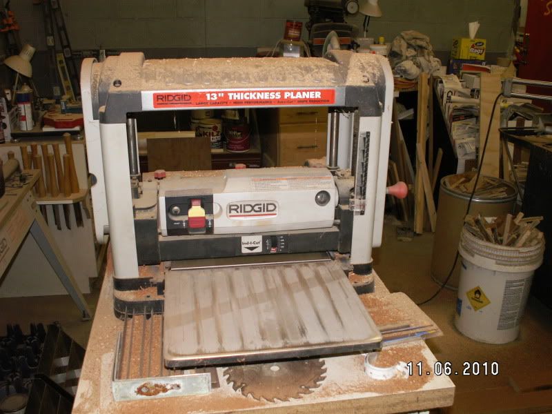

Maybe other people can do this quick but it took me all day today, part of another day and I still ain't done. Here's some of the toys I had to round up and use.
Good thing Eddie has one of these. It made quick work of getting the finish off the Mahogany.

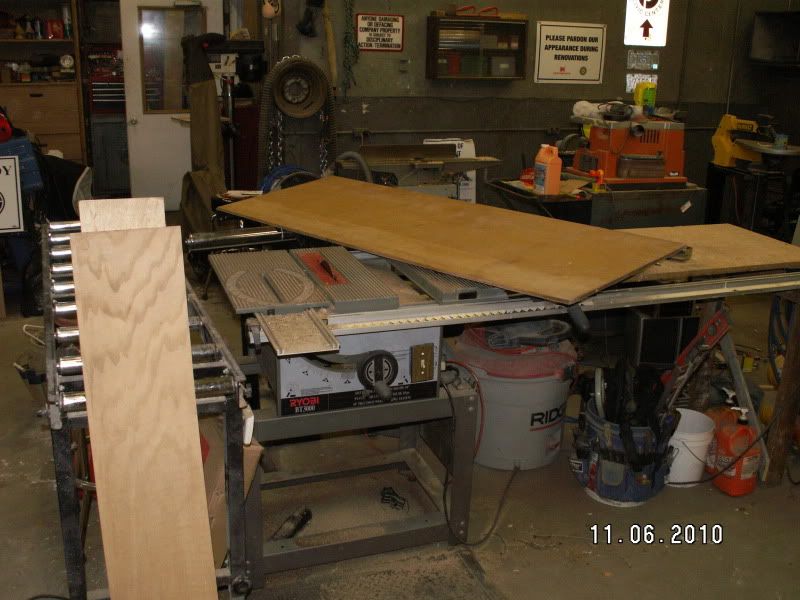

I like to disable the guard so I can see where the blade is going to cut. They say if you turn the saw on and put your fingers into contact with the blade the red will come out but I'm really big on keeping the red in so I don't put my fingers in there. Therefore the guard is completely useless as a safety measure but it impedes you from seeing where the blade will cut the wood.

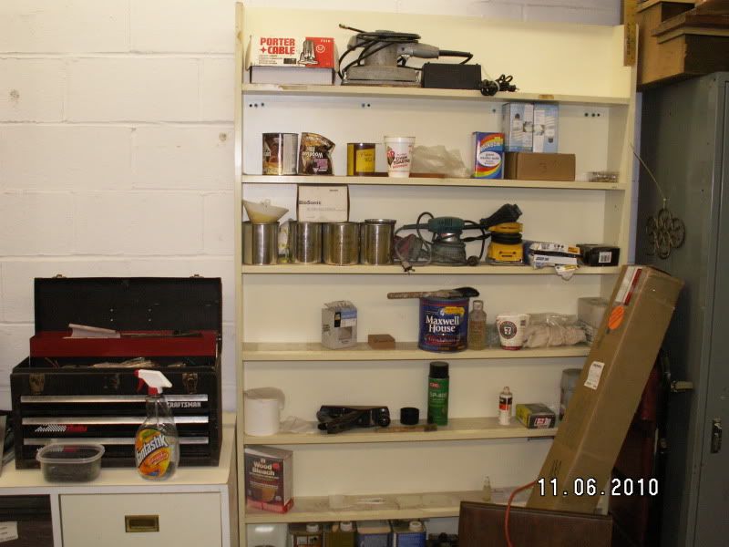

That rainbow looking thing on the narrow shelves is wood bleach

Nah, that's the shop of a serious wood working hobbyist. I'm a condo dweller. That particular wood bleach is the wonderfully poisonous oxalic acid. I've used it on a little oak table to remove black marks left by metal tacks but went on to treat the whole top. It took the red right out of the oak and made it look pretty cool with the added contrast of the brighter light part in the tangential grain.

This obviously isn't like one of Anunaki's threads where he practically comes to your house and builds it for you but in honor of the DIY crowd here's how it's done. The sides are 1/2" and the top, middle and bottom pieces are 3/4" so that you have something to screw into.

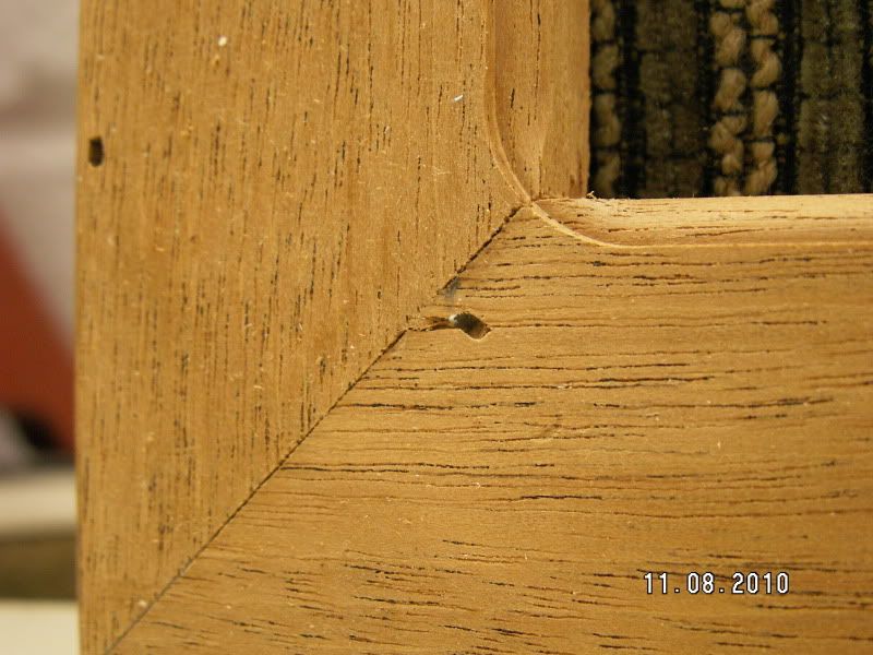

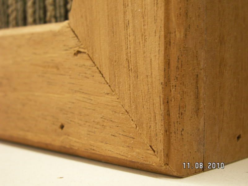

Here's the router detail at the miters. I could have used tiny biscuits to join the floating part of the mitered joint but ... well, you know.

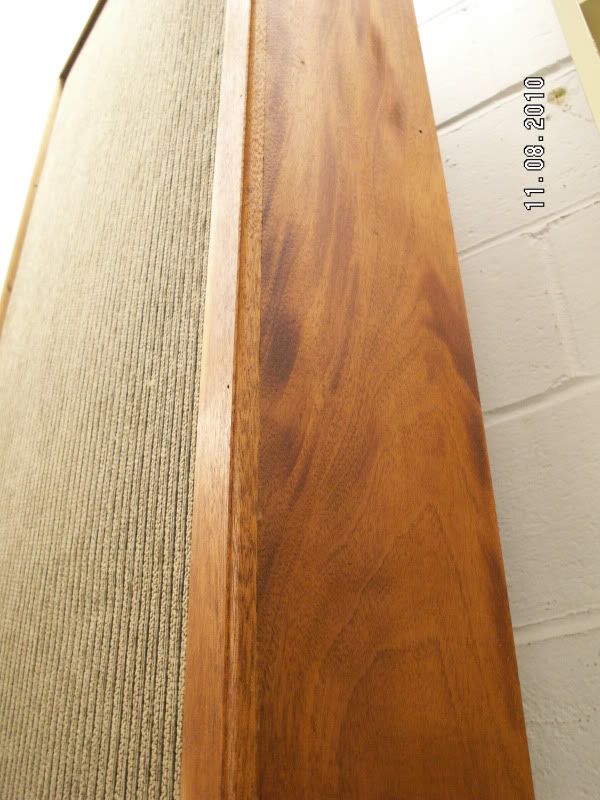

This is after washing with mineral spirits. It shows what the grain figure will look like with varnish. After looking at the close ups I think I might fill the pores before finishing to achieve a desired effect.

Thanks, Sean. Don't think it went smooth though. First I cut the trim pieces for the first panel way too short and had to mill up some more stock. Then a silly 1/16" of extra length on the trim pieces had me sanding up a storm. When attaching the trim pieces on the second panel my brad nailer blew a seal. I had to grab a finish nailer that uses 16 gauge nails instead of 18's. It left larger nail holes. I screwed the pooch on those miters because I was freaked about the glue setting up while I swapped guns. I mixed sanding dust and glue to fill the nail holes with a chisel and 5-in-1 painter's tool only to have it turn black from contact with the metal. The second batch for the second panel got mixed with plastic spreaders. My mineral spirits wash wouldn't evaporate because of the cold but I had to sand the nail hole filler off because I was afraid of what it might do to the wood surrounding the nail holes.
