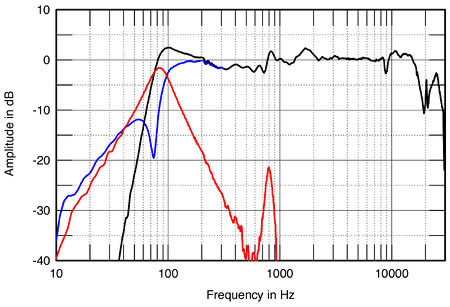

Imo Infinity P150 are decent for surround duty, but as-far-as use them as mains??
http://www.stereophile.com/content/infinity-primus-150-loudspeaker-measurements
Ok, but not great

Before you completely give up on the Infinitys - give them a chance. Their FR plot may not look all that fantastic - but you should hear what people have said about the Polk RTi A-line and I absolutely love my RTiA1's (at least for casual listening).
No matter what the chart looks like you're not in a competition and we're not talking about a black-or-white issue with speakers. Sure there are plenty that will sound better than those Infinitys - but there are plenty that will sound much worse. Plus everyone's ears are different - I really liked my Klipsch speakers for years... until I had auditioned many others speakers that didn't have horns on the tweeters - now I can't even take using them as PC speakers. :)
