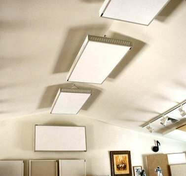

I personally think white acoustical diffraction tiles look pretty cool spread around a vaulted ceiling.
You might also go with some of these in an arrangement that breaks up the ceiling a tad:
You can pick the colors that work in the home. It's a piece of art!
