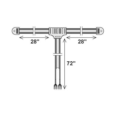

As you suspect, being in a basement apartment is a large part of your problem. That may be hard to fix. Your other problem is that you don't seem to have an FM antenna. There are inexpensive things you can try to see if all is not lost. Nearly all FM antennae are variations of the simple half-wavelength folded dipole. Below is a diagram of a simple FM dipole made from antenna wire. Note that it's about 56-57" wide, an average length that works alright for the whole FM radio band. Your receiver probably came with one like this when it was new. They are cheap, $5.45 on Amazon.
If you attach one to your receiver, hold the ends and stretch your arms out so the top of the T is horizontal. Turn around to see if it works in your apartment, and to see what direction gives you the best signal. Folded dipole antennae have a direction in which they work best. Think of a straight line between the antenna tower (you :)) and the radio station's broadcast tower. The best reception will be if the arms of the T shaped antenna are at a right angle across this imaginary line.

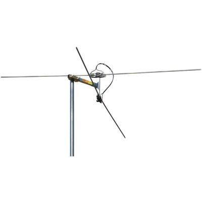

If neither of those work well enough, you probably need an antenna outside or on the roof. The 'turnstile' antenna that TLS Guy suggested is designed for outside use in a near urban location like Somerville. It has two folded dipoles at right angles, making it essentially omnidirectional. I have one like that in my attic. I live 15-20 miles away from most FM broadcast towers in the Washington, DC area. There are variations of this antenna type that are S shaped or circular.
Any antenna with more gain than simple folded dipole will probably have to go outside. An example is the high gain FM yagi antenna on TLS Guy's roof. He lives in the Minnesota boonies, and I doubt if you'll need that close in to Boston.

Charlie, welcome to AH. I see TLS Guy gave you his full attention on the subject of FM radio reception :D. None of what he says is wrong, however it might not be the simple and practical suggestions you need.

That antenna I specked is rated for indoor or outdoor use. It is only $17. In a basement apartment that likely has a lot of LED lighting in the complex, I think that is what it will take. In this day and age that might not do it.
You're right. If it can be used outside, there is no reason why it can't also be used inside. And $17 is cheap. I suggested the wire folded dipole or rabbit ears only as a test to see if it works at all. The omnidirectional turnstile antenna has no more gain than those two.
