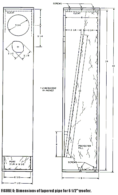

This offering does not sound promising.
This unit is a folded quarter wave pipe and NOT a horn.
Paul Voight caused this confusion back in the thirties. He designed the corner horn speaker which is a horn. He also proposed the quarter wave tapered pipe and called it a horn which it was not, and is not. It is a pipe. His proposal was a tapered undamped pipe, with the driver positioned to markedly reduce the odd harmonics. As far as I know, he never produced one.
The design was described in Gilbert Briggs book on loudspeakers in the fifties, and I still have my copy. I built the design age 7.
Decca produced a folded version for the GE 8" aluminum coned speaker around that time, and added to the confusion by calling it the "Decca corner horn."
The engineer was Ralph West.
In the stereo era I built a pair using the 4" JW metal cone speakers. Funnily enough I added an STC super tweeter!
Now these are pipes and NOT horns. However, they are the root design of the TL speakers, but with the taper reversed and the pipe critically damped.
Now to return to this tapered pipe, or TQWAT, as they are often known. The TL parameters required are not the same as those required for a horn, which required very low Qt drivers.
These drivers, the DX3, has a Qts of 0.225, and and Fs of 48.7 Hz. Those are the parameters for a horn design and not a TQWAT or TL.
So the bottom line is that Lowther do not have appeared to have developed a driver for this application. So the prospects are not auspicious for this new design. I would expect a speaker very lean on the low end.

Somewhere along the way, I had stumbled on a reference that Voigt never regarded his "Voigt Pipe" to be a good design worthy of producing; that they were inherently flawed.
Of course, Weems came along and folded it while blocking off a bit of the narrow closed end and giving it a CSA >0: the Driver ended up being moved slightly from the halfway point as well.
