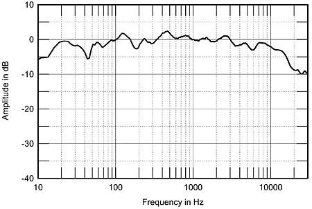

I see the logic to that since most speakers cannot go down to 20Hz flat.
But what about speakers like the Revel Salon 2 or the KEF 207/2 that can go down to 20Hz FLAT IN-ROOM RESPONSE (Stereophile John Atkinson's Room)?
Salon 2:
KEF 207/2:
