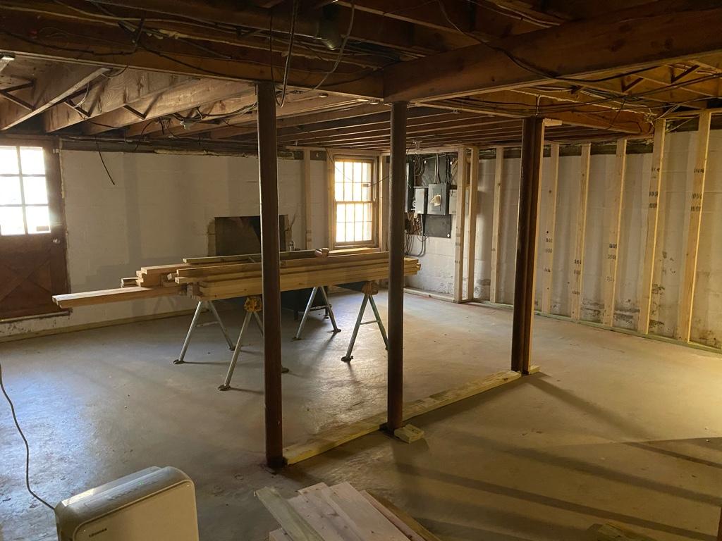

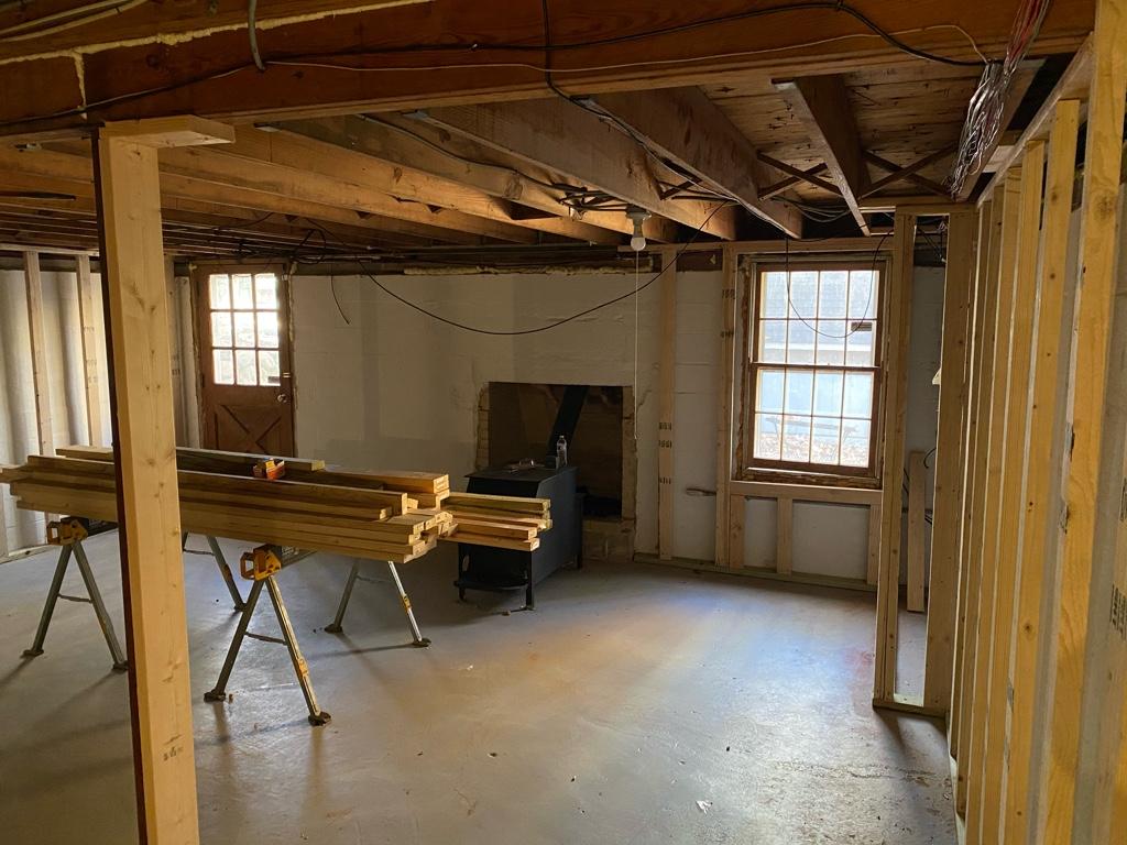

NIN is totally right Fred. If you have to mount the surrounds above ear level, your Atmos immersion and object placement will be compromised greatly. Do you have any pics?
fast fred
fast fred
The columns here will be Sheetrock
The far wall where the fireplace is, tv will be there
