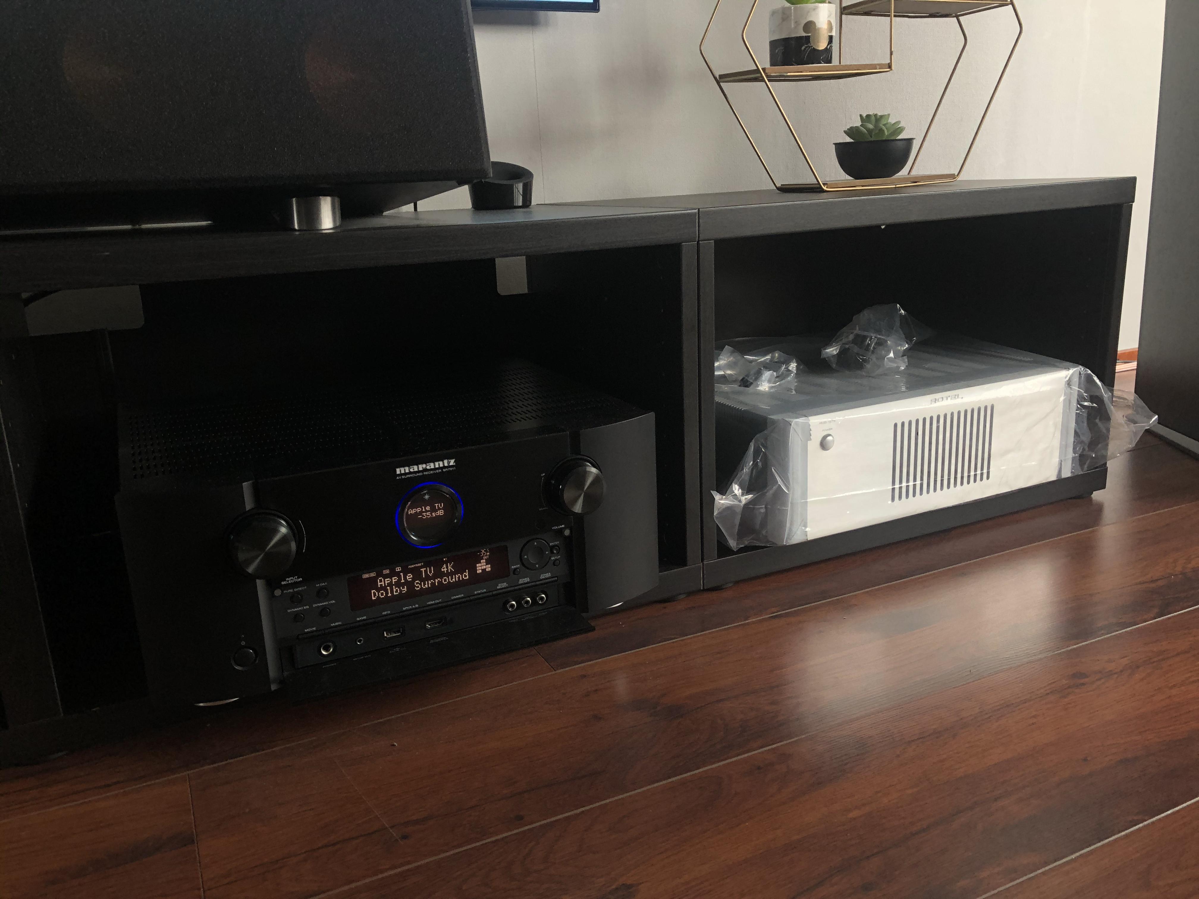

Today I’ve heard the right surround speaker clipping when watching the opening of a transformers movie with the volume on -5db below reference. To make sure it wasn’t a blown speaker I played the part back a couple of times and the moments I hear that sound were different than the first time. It was not a hard sound, but moderate. This was not the case before adding my Atmos speakers which have higher level trims in the AVR than the bed channels. That means they are less efficient than the other speakers.
I think I will buy an amp to give my speakers more breathing space. There are too many variables which can cause this issue. Also I don’t want to worry about the volume knob and I do want to listen to music all channels stereo if I feel like it. Also I think it’s a good idea to lengthen the life of my speakers and other gear. Eventually I will buy a processor instead of an av receiver.
Thanks for all the help and insights. I’m going for a one box solution, namely the Emotiva XPA-9.

Thank you for your detailed explanation. Which European multichannel amps do you advise? I’ve looked into the following options:
Marantz MM8077
Emotiva XPA-9 (one box solution, but 65 watts for Atmos speakers? I use the Klipsch RP-500SA’s and use them as DEAS.
Rotel RMB-1585
Yamaha MX-A5000 or MX-5200 (one box solution)
Marantz MM8077
Rotel RMB-1585

Thank you. Unfortunately how much I would like to stack a bunch of Crowns, it’s not an option since the system is in a living room. I am looking for a one box solution. Three channel amps are not available in the Netherlands. Emotiva is not an option anymore.
Audyssey set the level trims of the DAES speakers 5db higher than the bed channels. I’ve double checked the levels with REW and they are level matched correctly with all the channels in the system.
Still, I have not bought a multichannel amp yet, because of the poor choices we have in the Netherlands. I can only choose between:
Rotel 1575 (can buy it for 1100 euros new)
Marantz 8077
Rotel 1585
Yamaha MX-A5000/5200
I am leaning towards the Marantz, off course because of the same make as my receiver. But I can’t find a lot of experiences of that machine online. The Rotel 1575 has bad reviews from users and others like it. To many subjective opinions.
My goal is to buy a model which can last for a long time to come. I am planning to buy a pre/pro somewhere in the near future. So at the moment the priority is to choose an amp which should be a set and forget purchase. I want a good amount of headroom and don’t want to worry about the volume knob. Also I am looking for a one box solution which can be perfectly paired with my speakers (150 RMS nominal, 600 peak I think). I am not looking for a “warm” sound, just a pure amplifier with a low noise floor and can fulfill my needs for movies and music (music in “Dolby Surround” mode always).
Outlaw and Monolith are unfortunately not available in The Netherlands. Importing those models are a headache because of customs and shipping costs for one.
I would appreciate some advise which multichannel amp is best for my setup.
Marantz 8077
Rotel 1585
