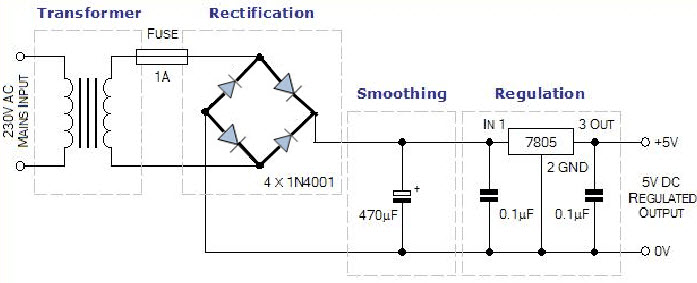

As to your unit, I suspect a power supply issue, as it affects both channels. My hunch is the louder state is the correct state and that there is a section not being supplied the correct voltage on the quieter mode. That unit is new enough that there are probably solid state voltage regulators. I would suspect something do do with voltage regulation.

Is there a chance I could get a schematic from you on this unit so I could begin to trace back the voltage drop ...I agree that type of problem is what I have and I also agree that the louder sound is the correct sound it is more clear with stronger treble tones to it. I think the coil is feeding a set of four diodes , two per amp side and I have as you say a voltage lose on one side But I am really not sure what is suppose to be happening here .
Do you or anyone else know how to test or measure this voltage regulator?

I'm sorry, I left I vital word out of my post. I can not get a free service manual or schematic for your unit. If you do search though you will find service manuals for purchase. I do not have a manual or schematic for your unit.
Once you have a manual it should show correct voltages. You will need to measure the voltage to various sections.
Now you have to work on units live and there are high voltages. To make it safer to work on equipment a Variac is strongly recommended.
The four diodes are a bridge rectifier.
I suspect your problem is in the regulation part of the circuit.

Thanks for the diagram. Starting to make some sense I have replaced the caps on both sides of the stereo system, so the 470's and the 0.1 uf but until I did some reading on the voltage regulator I had no idea what it was for. I also checked out how to test the little thing so good to go there. What I hope to see is one of these is not delivering properly. I don't even know what the voltage should be coming out.. I Do remember that the flow on the board is printed as 35V and the caps purchased were for 35 V as well so the out put will be less than that. Would it be correct to say if the measured voltage is not the same going into the regulator then the up steam diodes are messed up?

Given the date I suspect the power amp section is unregulated. If the voltage was low at the output stage then it would distort and sound awful. I suspect that the voltage gain stages are regulated and the voltages are usually of the order of a volt, sometimes +5/-5 volts.
Now you can do lot of damage testing a unit like this with a standard multimeter. This type of service requires an expensive amplified high impedance meter of the order of 2 megohms.
