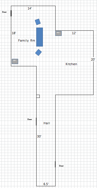

The hallway adds another 30 ft. x 6.5 ft. x 9 ft. = 1,755 cubic ft. Not sure if this should be added or not, but if I do, I get 6,489 cubic ft. See floor plan sketch below. Subs are the gray boxes in the front left and rear right positions relative to the couch and chairs (blue boxes).

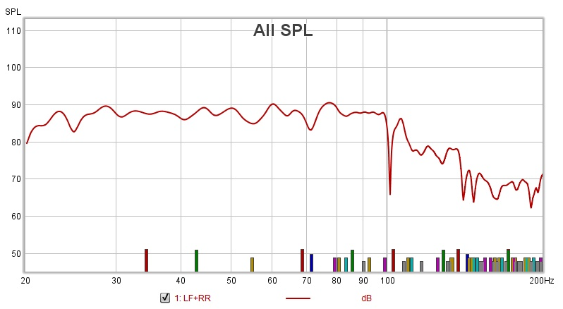

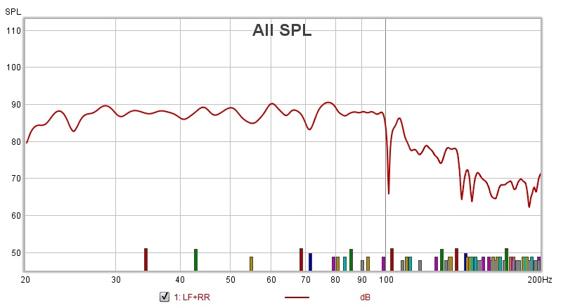

I'm thinking the PC-2000 Pro is just not enough of an upgrade to make it worth while, but could be convinced it is. The HSU/ULS-15 is very interesting (I read the review by James here) although the most expensive choice, kind of leaning towards this one. I like the small size relative to the others, weight is acceptable. I'm getting good bass down to 25 Hz or so with my current 12" sealed subs (see REW picture below, this is with miniDSP and REW EQ). Seems the HSU/VTF-3 kills the ULS-15 in output almost everywhere, but maybe I don't need that much? Heaviest of the bunch and at the max of what I would consider weight wise.
