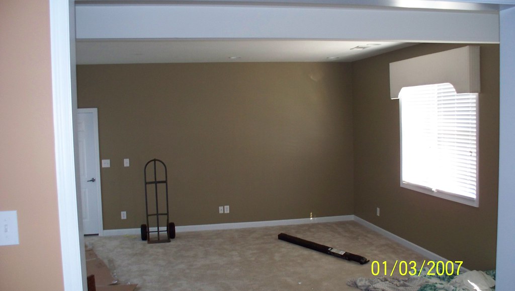

Unfortunately this isn't in a basement. But most of my movie viewing will happen at night anyhow.
The room is ~ 22LX18WX11H I will post some pics...

Well PJ can be done in that room, but you will need a curtain for the window. Do your lights have dimmer? If not I do suggest you get one.
An easy way to figure out the problem lights is to turn on a light and see if it lights up the wall. It also appears you have an open back area, if so you will need a ceiling mount.
I love PJs, but for that room I'd almost suggest a TV. I just think a PJ maybe more work than it's worth.
Well, the lights turn off... and I was planning on ceiling mounting it from the get go.
I am not sure why it would be too much work.

I suggest we do the Sanyo since it's very placement flexible, quiet, with no possible Rainbow Effect. Get a nice curtain for the window and you should be good to go room wise.
You can use the projector center calculator to get the appropriate starting size at least. You will need to determine a screen size before you can try out the PJ.
I suggest a few experimental trips to the movies to see what your household prefers unless you already know.
If you don't mind a higher screen you may be able to use a matching center at ear level. But don't get carried away or eye strain will get you.
