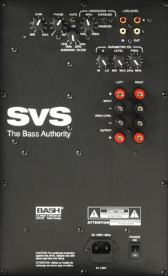

Until now i have been using only 2 speakers and a sub, that was set up using the subwoofer crossover (reviever -> sub -> frontspeakers), but i just got some new speakers that i want to use in a surround, so that i can get the full experience when watching movies with 5.1 tracks.
I thought it would be a good idea to let the receiver handle the crossover, so i rewired the system.
Now the system is connected as shown below:
  • Reciever — (RCA) —> Subwoofer
  • Receiver — (Speaker cable) —> Speakers
When i listened to music with the old 2.1 setup it sounded MUCH better since the subwoofer also blended in, but i was missing the surround channels in movies and games.
My 4.1 hardware setup:
Receiver: Marantz SR4500 - crossover set to 100 Hz
Speakers: Scandyna Minipod (SB)/The Drop (Front)
Sub: SVS PC12-Plus (old version/525 W RMS BASH amp) - crossover set to max.
Sources: Computer (toslink), PS3 (Toslink), Airport Express (minijack-RCA stereo)
Source output settings:
Computer audio card: Set to output DD5.1/Dolby Pro Logic/Dolby Digital Live
PS3: Set to output DD5.1
The problems:
  • The sub is only activated when the receiver is fed with a DD/DTS 5.1 signal.
  • If the receiver is fed with 2.0 track, then the sub will not be activated
What i would like:
  • To listen to music in stereo/multichannel stereo and also have the subwoofer playing (by using the crossover in the sub)
  • To be able to listen to a DD/DTS 5.1 track from the computer/PS3 without missing out on the 0.1 channel
  • Maybe be able to use the 7.1 inputs in the receiver for PCM HD audio in the future if i should upgrade my soundcard at some point (Not a requirement, but could be nice to have)
My solution/theory/question
My theory is that to get the best from both worlds (stereo and surround) is to let the frontspeakers go through the sub LPF/HPF to blend in the sub in stereo AND connect the sub pre-out on the receiver to RCA input on sub to also be able to get the LFE channel in DTS/DD5.1 and then set the receiver to “Large Fronts, Small Surround and Subwoofer enabled” in the setup menu.
Is it safe to connect it this way? Is there a reason why i shouldn’t? I really don’t wan’t to break anything by connecting it wrong

F
Fodox
Thanks for all your answers and being slow to reply in my own thread, but it has been a busy week for me so far.
About my the receiver speaker configuration:
Fronts are set to small, Subwoofer is enabled.
I just only seem to be able to get it activated when listening to DD5.1/DTS5.. Else i have to set Surround mode to CS2. Even them it sounds pretty weak and it sounds somewhat like a computer satellite surround setup. I really don't like the sound in that mode.
I have however changed the wiring back to my old setup, where I connect the speakers through the subwoofer. The crossover is set to 70 hz on the sub and it blends in nicely with the speakers i think.
In the receiver the speakers are now set to Large, the subwoofer is disabled, and now it sounds WAY better IMO instead of when just using the sub pre-out (RCA).
Since most think it would be a bad idea to connect my system the way i suggest, I think i'll just keep my current setup as it is now, so I guess I'll just have to live with not being able to get LFE when i want to use the 7.1 input in the near future.
Thanks again for spending your time answering my question:)
