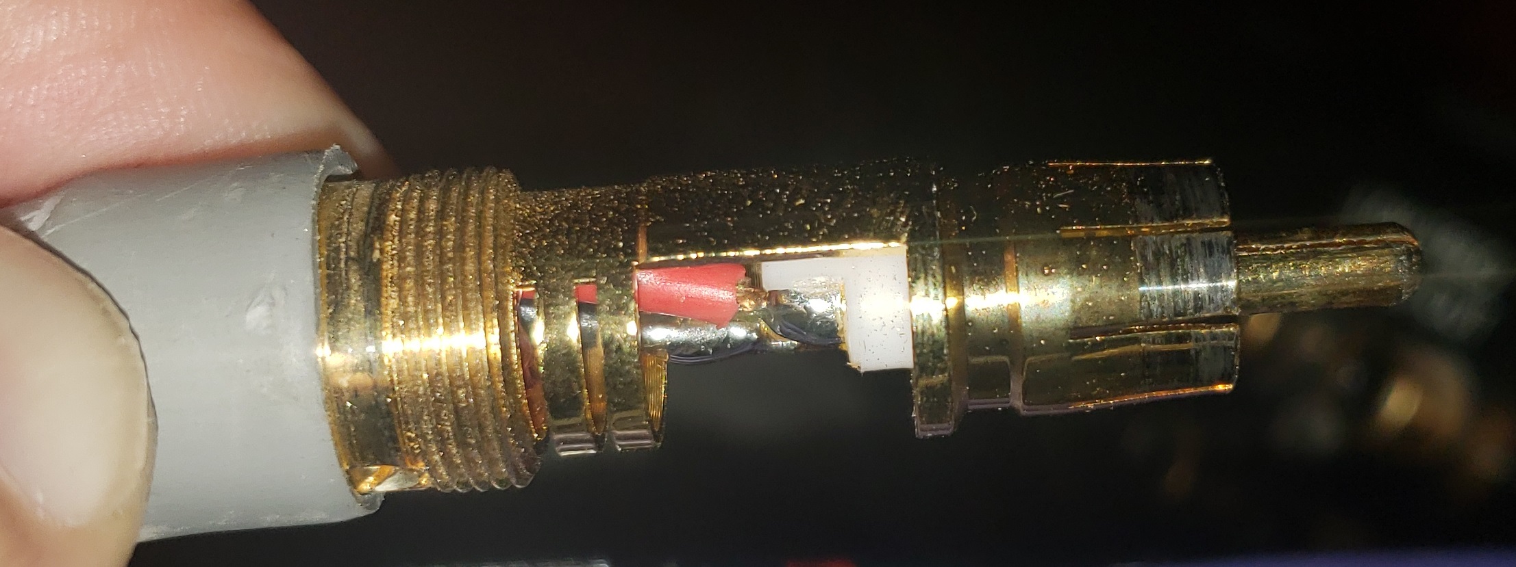

I used past tense and said "until ~1 hour ago" due to a series of major issues while doing the test above in which I moved cables from servos to preamp, leaving me in a worse position than when I started. The RCA cables outputs from the servos have a screw lock mechanism. You need to unscrew to release or attach. My preamp didn't like this screw output system. I initially attached the fronts woofers cables to the preamp rather than the subwoofer cables. I realized the error before turning it on, but could not get the front woofer cables off the preamp. I believe the cables were too close together on the preamp, and the pressure from the angle kept the screw lock on. After ~30 minutes of unsuccessfully trying to unscrew with hands, I resorted to getting a good grip with a plier like tooi and turning at unnatural angles. I eventually got the cables off the preamp, but I may have damaged the connector in the process. A picture is attached. After reconnecting, now I get a low hum from one of the front woofers all the time. The hum is at exactly 60Hz and too loud to ignore. Muting, changing the volume, or unplugging the preamp does not influence the hum. Turing off the servos where the suspected bad cable begins eliminates the hum. Turning off the amp where the suspected bad cable ends also eliminates the hum. Swapping out the amp with another does not eliminate the hum.

Somehow I suspect you damaged a ground in that mishap.
