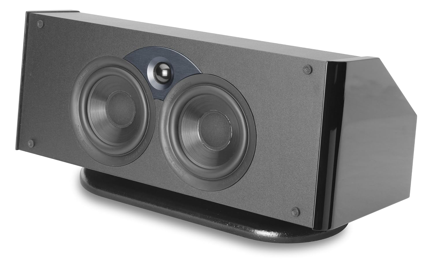

3-way centers like that SVS Ultra center do not have nearly as severe problem with comb filtering as 2-way center speakers. It's the MTMs that you have to be wary of. The SVS speakers pushes down the crossover to the bass driver so low that lateral lobing from the bass drivers aren't even a big deal since the room acoustics will screw up a lot of that low frequency response anyway. 3-way centers that align the midrange vertically with the tweeters is an intelligent center design. Another good way to build a center is to raise the tweeter and push the midrange or bass drivers so close that they act as a single woofer in their frequency band, like so:
You could also use a single coaxial driver design like Hsu's CCB-8, KEF LS50, or the JTR Single 8HT, none of which obviously could not have a lobing problem.
