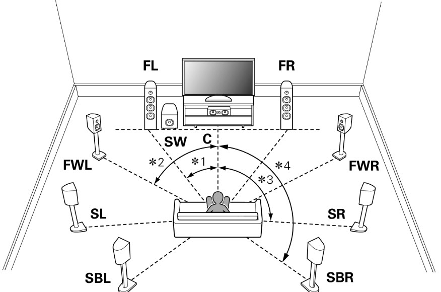

So now I'm doing the audio setup/calibration on my denon 6400h. And I have a 5.1 set up. Its asking me if I have surround speakers and I say no. And it stops thinking I have 3.1. I am trying to get the speakers to be back left and right speakers. Am I missing something or am I stuck with FR,CENTER, FL, LS,RS ? is there any way to set it up with FR,CENTER,FL, BR,BL?
Any advice is greatly appreciated

Or is the surround left and right the proper output for the 5.1? I've only had an all in one system and I just thought the back speakers were called back. But could they have been surround left and right this entire time?

Surrounds are side and back. In a 5.x or 7.x system the side surrounds should be as close as possible to ear height and on axis.

Yes they are surround right/left. I noticed they’re also in a very poor spot to deliver good imaging and surround experience. If you really do want to do atmos, there are ways around a vaulted ceiling, but you will need to move your surrounds for it to work properly.

I would try to put your center a little higher (right under the TV) or maybe angle it so the front is directed more towards the listener. You need to connect your "back" speakers, in your case SL & SR -see photo below, to those posts on the rear of the receiver. The ideal is to get the surround speaker placement to resemble the photo as close as possible with the tweeters at Ear Level.

I would try to put your center a little higher (right under the TV) or maybe angle it so the front is directed more towards the listener. You need to connect your "back" speakers, in your case SL & SR -see photo below, to those posts on the rear of the receiver. The ideal is to get the surround speaker placement to resemble the photo as close as possible with the tweeters at Ear Level.View attachment 27180
Great info. Thank you so much. I got this one in hopes of explaining one day. My living room cuts my options for speaker placement. My WAF is super high but shes not letting me have speakers hanging off the wall lol or placed in front of the wall.
