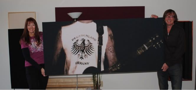

As far as treatment there really is not much you can do if the wife is not going to let you put up some treatment. Is there a reason she is against panels on wall? If so you could make panels with art on the fronts. The process is called dye sublimation, which dyes the image onto the fabric which will not mess with the acoustic properties. Here is a image of my own I did for my condo.
