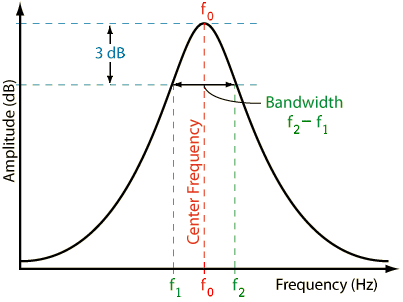

Now, the Sigma SSP has a 9 band per channel parametric EQ…
Here is the manual: http://www.classeaudio.com/pdfs/Owners_manuals/Sigma-SSP_ENG.pdf
Page 42 shows the settings.
In short: per channel, there are 9 assignable filters with assignable "center frequency", gain, and filter Q. I think I understand what the first 2 mean but the last one is not clear to me. I also a little unclear as to where to start and where to go from there. ;)
