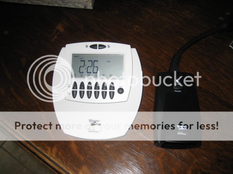

Just incase I wanted to go cheap, is there a plug in RF system that would work just for the lights? Maybe something like this but better?
http://cgi.ebay.com/Home-RF-Remote-Control-Power-Outlet-Light-Switches-NEW_W0QQitemZ120526665699QQcmdZViewItemQQimsxZ20100206?IMSfp=TL100206021007r34755
