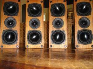

Hey, how do you like the speakers? There have been 4 James Audio speakers for sale on Craigslist out here for $350 for a long time now. They look like competent speakers, but I have no experience with their stuff.

I have had 2 James Audio center channels, and they have been phenomenal.
