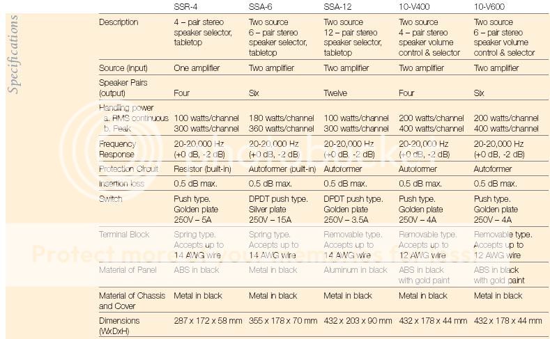

Whole house audio:
Imendance Matching Speaker selectors:
What I asm confused about is where it says Source (Input) it says you need two/one amplifiers. I'm assuming that the receiver alone will not be able to handle those selectors.
We will probably end up getting two of one of them (depending on the price, I would like to get two of the 10V600's)

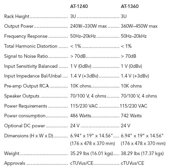

Here are specs on some amplifiers:

Anyone? Does the speaker selector, if I get one, it looks like it has a A/B selector on it. Does this mean I can use 12 sets? or not?
