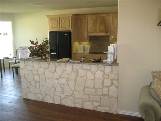

Sorry JohnD. Most guys that repond to me are familar with my layout. My listening position is 11 feet from my plasma and LCR with the sub being within the sound stage. The depth of the room as layed out for the HT is 20 ft deep and 25 ft wide with 14 ft ceilings. This all opens into a kitchen whcih is behind the listening area.
I have attached a couple of pictures here. One setting near the listening position looking at the HT, the other is showing what's behind the listening area.
