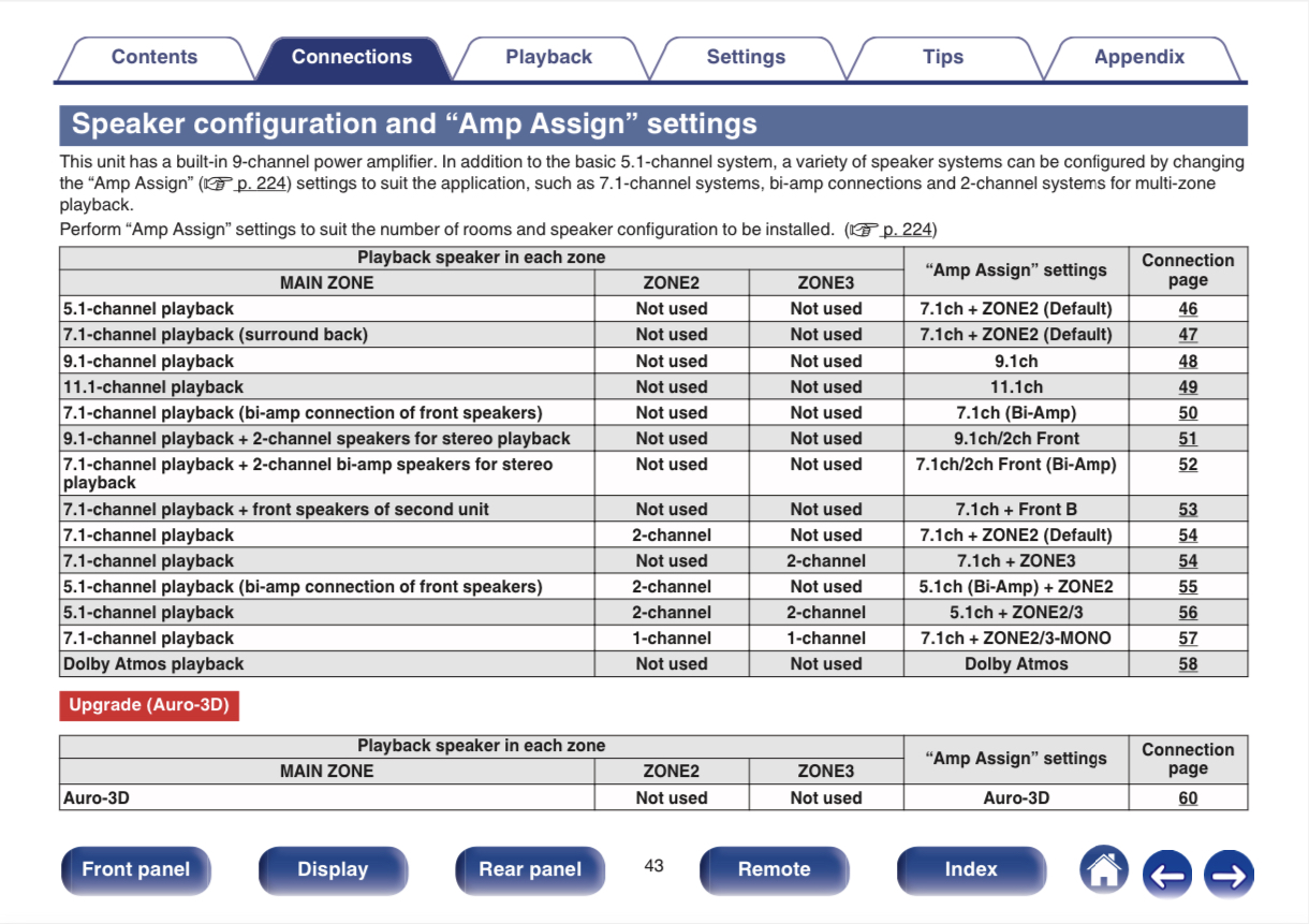

Do you have all those things needed for your amp assigment? It could eliminate other choices. LFE+Main is fairly easy to implement on a case-by-case basis, altho you would have to change it manually when you don't want to use it for something else. Don't confuse LFE and bass management....
No, I only have 5.1 speakers. But there was some reason why I had selected 7.1Ch+ZONE2/3-MONO, but I can't remember what it was, sadly.
Well if you don't have zones in use seems one of the basic modes like 9.1/11.1 or whatever choice you have would be sufficient.

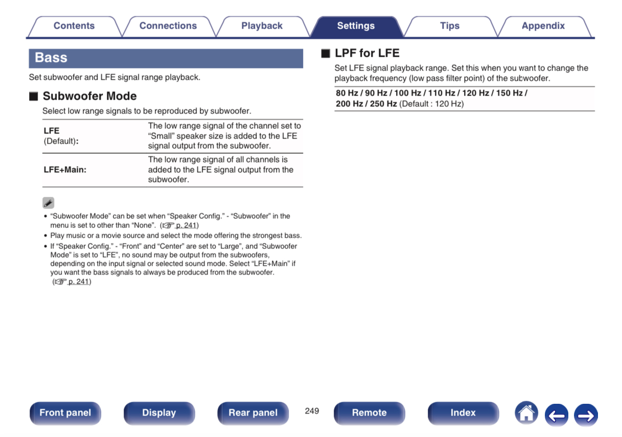

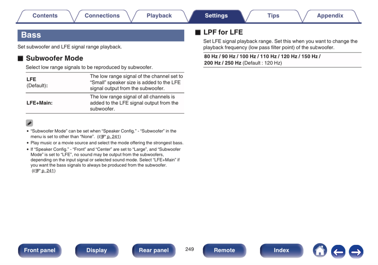

That does not seem to be the case with my Denon AVR-X5200. I'm now in the setup with my fronts set to Large, and in the Bass setup, Subwoofer Mode, I can select either LFE or LFE + Main.
While being able to select both, one must select LFE+Main when FRONT, and CENTER in this case, are set at LARGE for audio to always be produced by the SUB.
If not using any other Zone, the first default assignment would be appropriate.

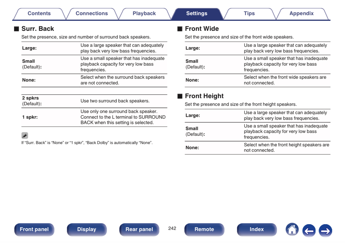

With any assignment, unused channels should have the speaker size set to None.
Well just from seeing the above, it looks like what I'm looking for is that LFE+Main setting with my mains being all large and surrounds set to small. I guess I just need to make sure whatever model I go for has that or similar option depending on the jargon used.
Thanks. Based on that, then I would think my two surround speakers would also have to be set to Large. Mine are sizable towers, so I already have them set to large.

There still seems to be confusion about the feature and manufacturer manuals can be of little help when one is trying to figure out exactly what they do. There shouldn't be any confusion based on the pages inserted in earlier posts concerning a particular Denon model. Keep in mind that having speakers set at LARGE means no signal to the subwoofer UNLESS the DOUBLE BASS, EXTRA BASS or LFE+MAIN features are turned ON. Sending a full signal to front channels means they get it all. So, the AVR will not reroute low signals to a sub. This is the case with two channel as well as multi channel material.
Denon/Marantz have the best designation for the feature and I think can still send a signal to the sub in a multichannel scenario based on the sound mode using just the LFE setting. That is at least what they seem to indicate in their manual. This is not the case with Onkyo/Pioneer and Yamaha. Run Mains at LARGE with Onkyo/Pioneer receivers and get nothing from the sub UNLESS the DOUBLE BASS feature is turned on regardless of the audio signal. Run Mains at LARGE with a Yamaha and get nothing from the subwoofer UNLESS EXTRA BASS is turned on.
Onkyo actually prevents the activation of DOUBLE BASS when speakers are set to SMALL because it is only meant to be used with the LARGE setting to extend the low range signal to the subs when Mains are running at Full Band. Setting a crossover essentially sets them at SMALL compared to LARGE being Full Band. Yamaha receivers work similarly when Mains are set at LARGE but, and this is a big BUT, they also allow EXTRA BASS to be activated when Mains are SMALL and this actually applies an artificial bass boost to ALL of the speakers. This is a no no.

So, in my case with 5.1 system and not using any zone, the correct(first default) assignment would be 7.1ch+ZONE2. Correct?
Yes. Don't forget to set the unused Surround Back and Height Speakers to None.
