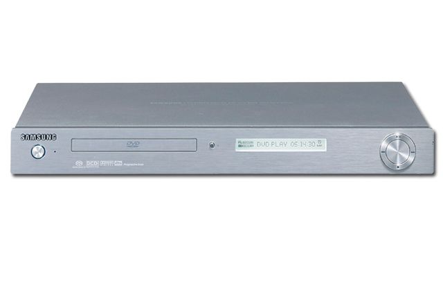

Here's the Samsung dvd player:
http://www.amazon.com/exec/obidos/tg/detail/-/B0009MD8ZI/104-8060217-9334351?v=glance&s=electronics&vi=reviews

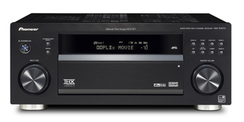

Thanks buckeyefan and spiffyfast, I'll look into those speakers. I want to go with bookshelf speakers on stands to conserve space and cost. The budget definitely isn't set in stone. I would rather wait a little longer and get something a little pricier if it's worth added cost. I've been looking at pioneer receivers. Been reading a lot about the 1015 and 9100. Either sound like a great receiver. I'm just wondering if I won't be able to use that much power and I should get something less expensive like the Pioneer 815k you suggested Spiffyfast. What do you think?

You'll use all the power of the 1015. It might seem like a ton, but when you really crank your system, you're going to want an amp section that doesn't peter out and start clipping when you're trying to rock out.

by all means, if this is a system you plan on having for awhile, get the 1015tx you wont be dissapointed at all, and should last you for awhile. may be more power than you need now, but you know you'll have it when you want it

Good point. That's why I suggested the Samsung for $59. Great disposable dvd player which is progressive scan, has dvi outputs (dvi to hdmi cords are available), dvd-a/sacd, and high-definition upconversion (from 480i/p DVD-Video to 720p, 768p, or 1080i). Those features are hard to touch for 3x the price.
Wow- that's for sure. Assuming the quality of the the progressive scan is good, you can buy the player for a couple bags of aluminum cans!
